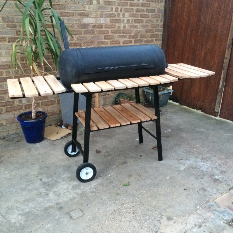

Go for it, I used 35mm pop rivets to secure the wood to the steel frame. Applied a couple of coats of wood preservative followed by some clear decking oil, should last a few years just sat outsideI shall be shamelessly copying your pallet wood idea there.
