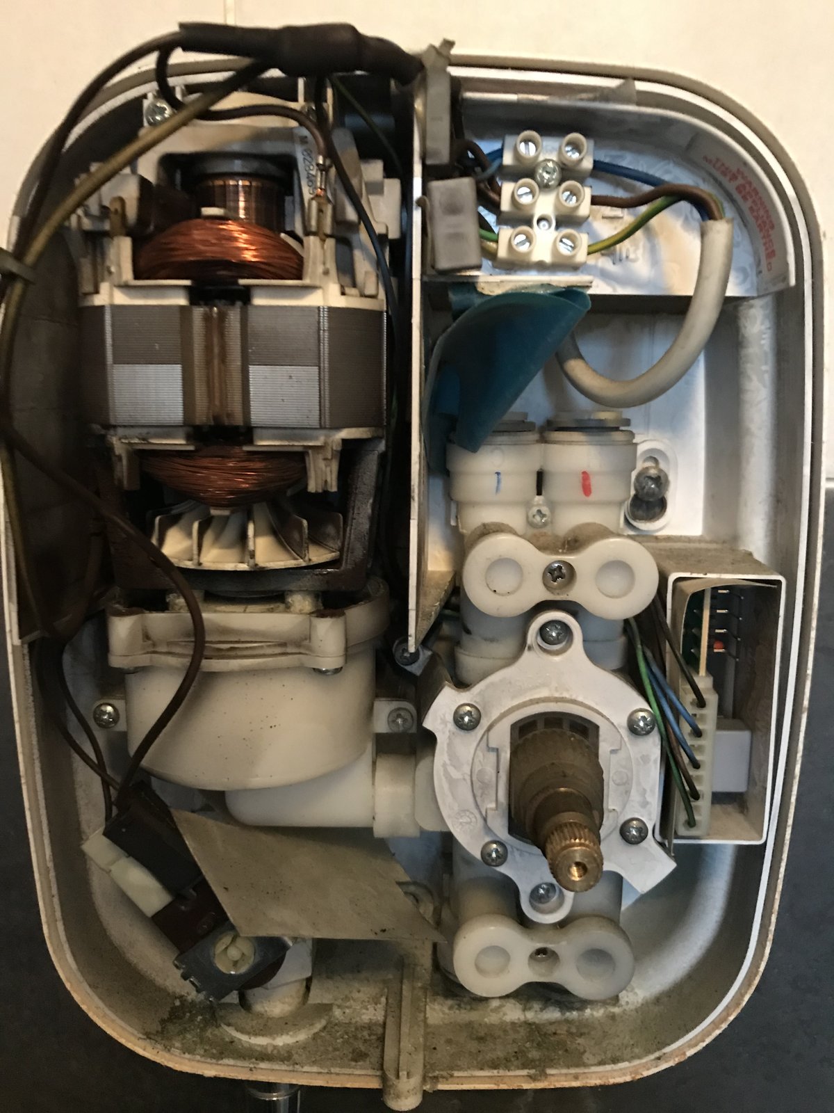

Just recently our shower stops working after 3 mins or so. The shower pump makes a slightly higher noise and the water stops coming out, works fine for 3-4 mins with plenty of power then no water.
Rest of the water system/heating/bath etc working fine. Its a little Triton thermostatic power shower job and its been in for a fair few years with a fair bit of use.

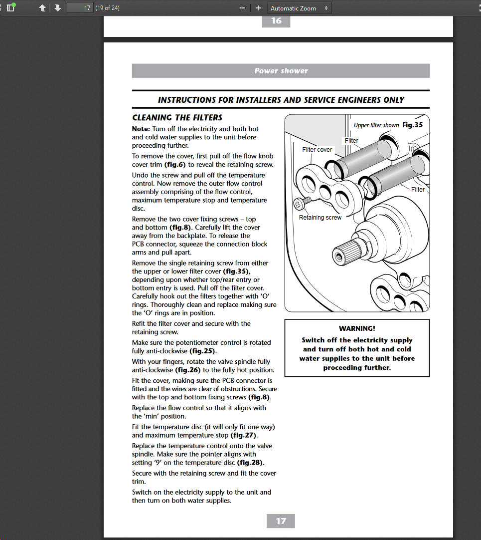

Is there anything worth checking on these if I open it up, or time for a new shower?
Thanks for any advice
