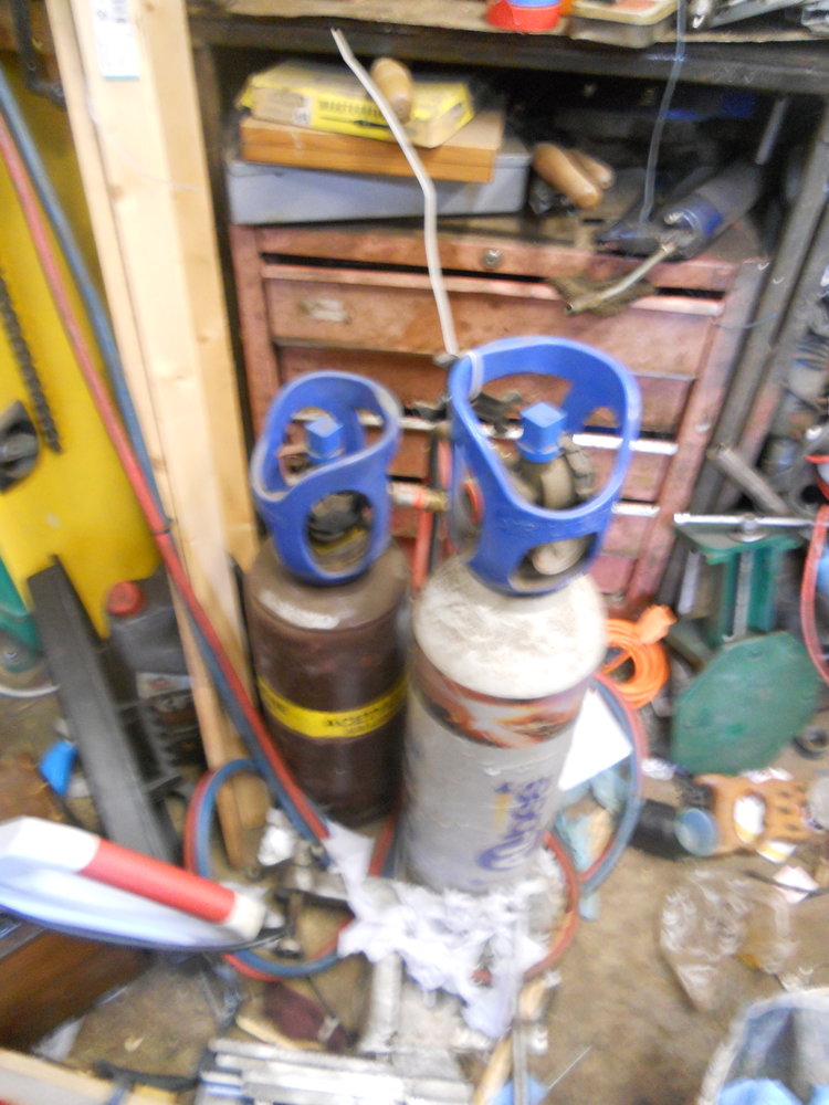

Has anyone started using propylene rather than acetylene?
I see Adams Gas stock it, and claim 50% cheaper than acetylene, 80% reduction in cylinder changes as a cylinder is just propylene not acetylene disolved in acetone, and is better than oxy propane for cutting.
Then confusingly having pushed all its virtues go on to say:
"Acetylene is the primary fuel for oxy-fuel welding and is the fuel of choice for repair work and general cutting and welding. Acetylene produces the hottest and most concentrated primary flame of all industrial fuel gases. Its calorific value is fairly low, but the portion emitted by the primary flame is very high, about 30%, making acetylene the fuel gas that produces the most heat in the primary flame."
They claim that you just need to change the tip so ??presumably?? you can use acetylene regulators with it.
I'd like to hear some real life experiance if anyone here is using it as it ain't cheap to buy cylinders 'just hoping'
