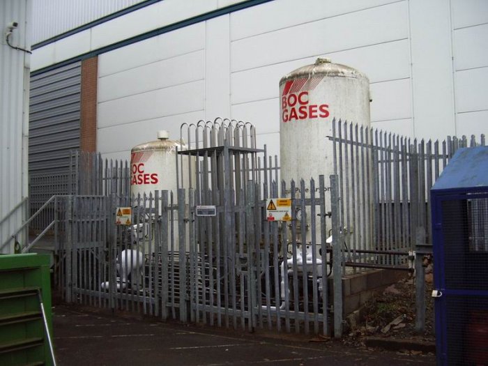

Just after shift start this morning the welding machines stopped one after another on low gas pressure alarms. Found our gas bottle was empty...
We had ordered gas on tuesday but it had not being delivered so we switched to our backup manifold cylinder pallet which we had not used before, it ran for about 10 mins before the regulator froze due to the demand
(the company who specified/installed it are going to get roasted!) managed to get it going by balancing a fan heater above it
Gas turned up about 1030 and took 1600Kg to fill tank.
