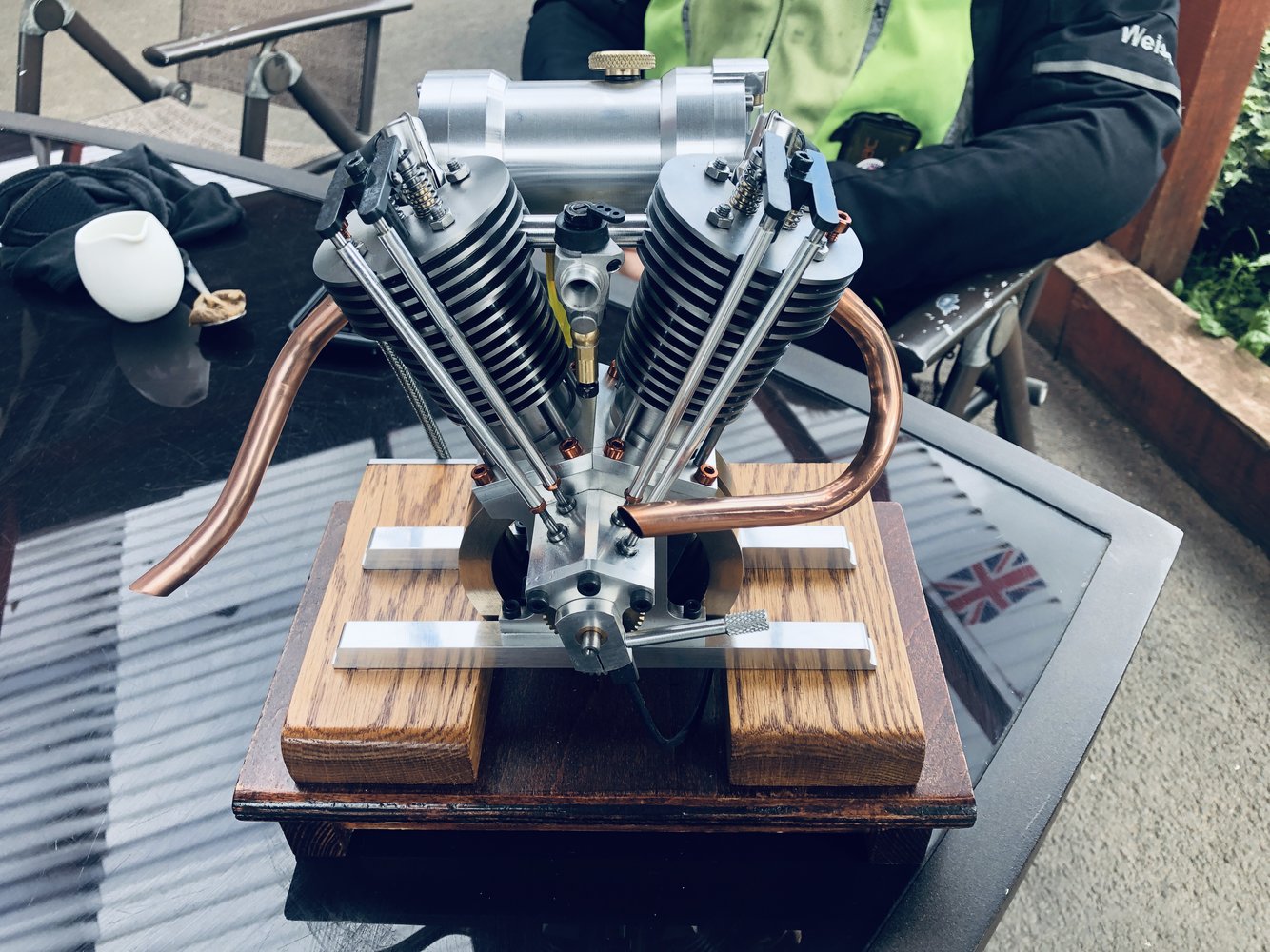

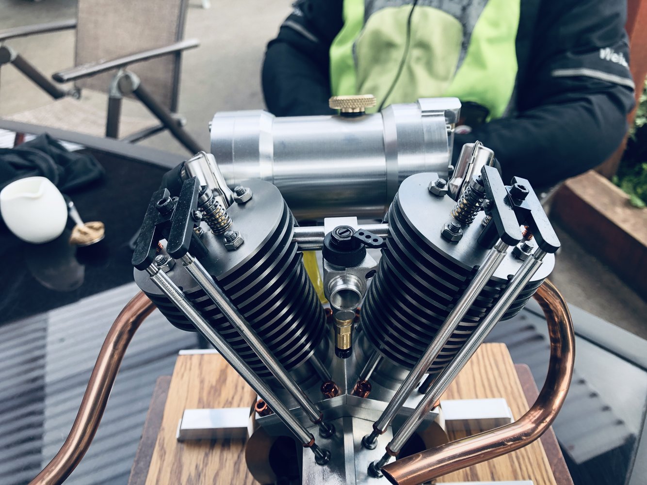

The original drawings are apparently based on what the designer thought an early Harley motor would have been like. The guy who built it took his own liberties with much of the construction, even made the valves, piston rings, valve springs, rockers etc. Cylinders are machined from cast iron. Bottom end runs in PTFE bearings, so no crankcase required.Hoglet?
