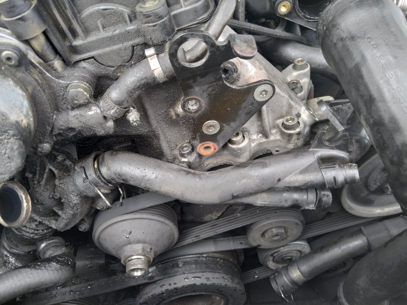

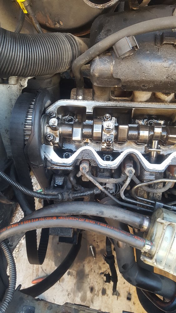

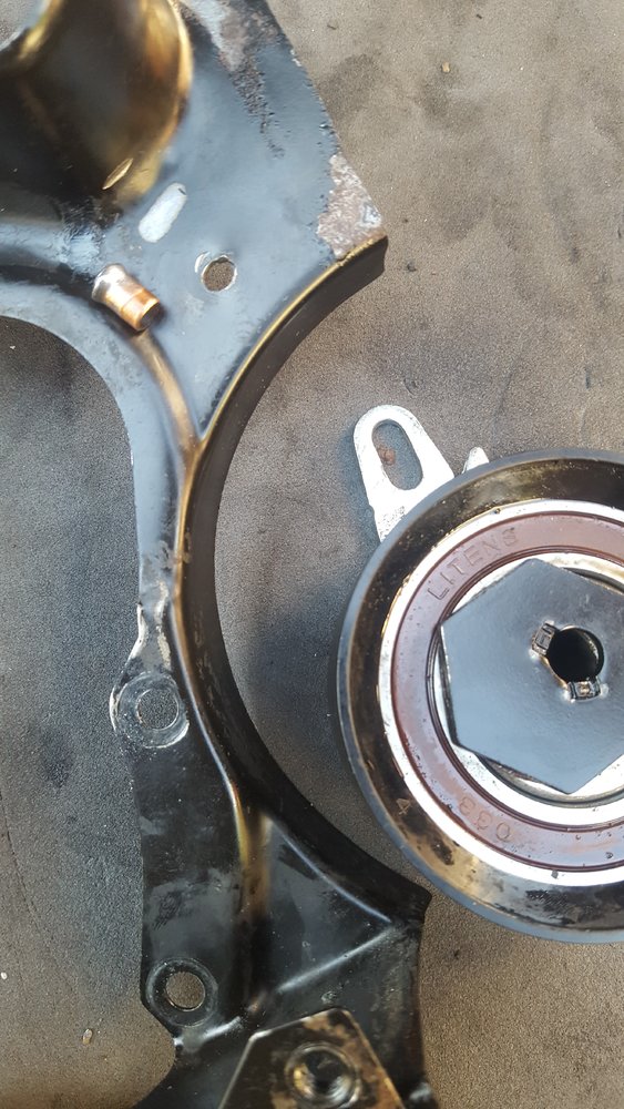

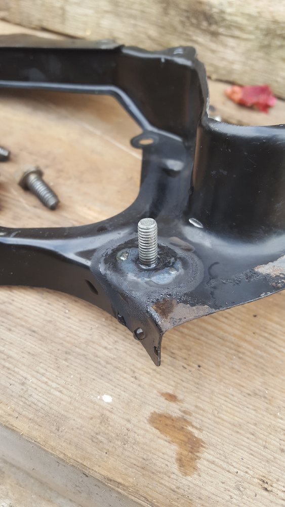

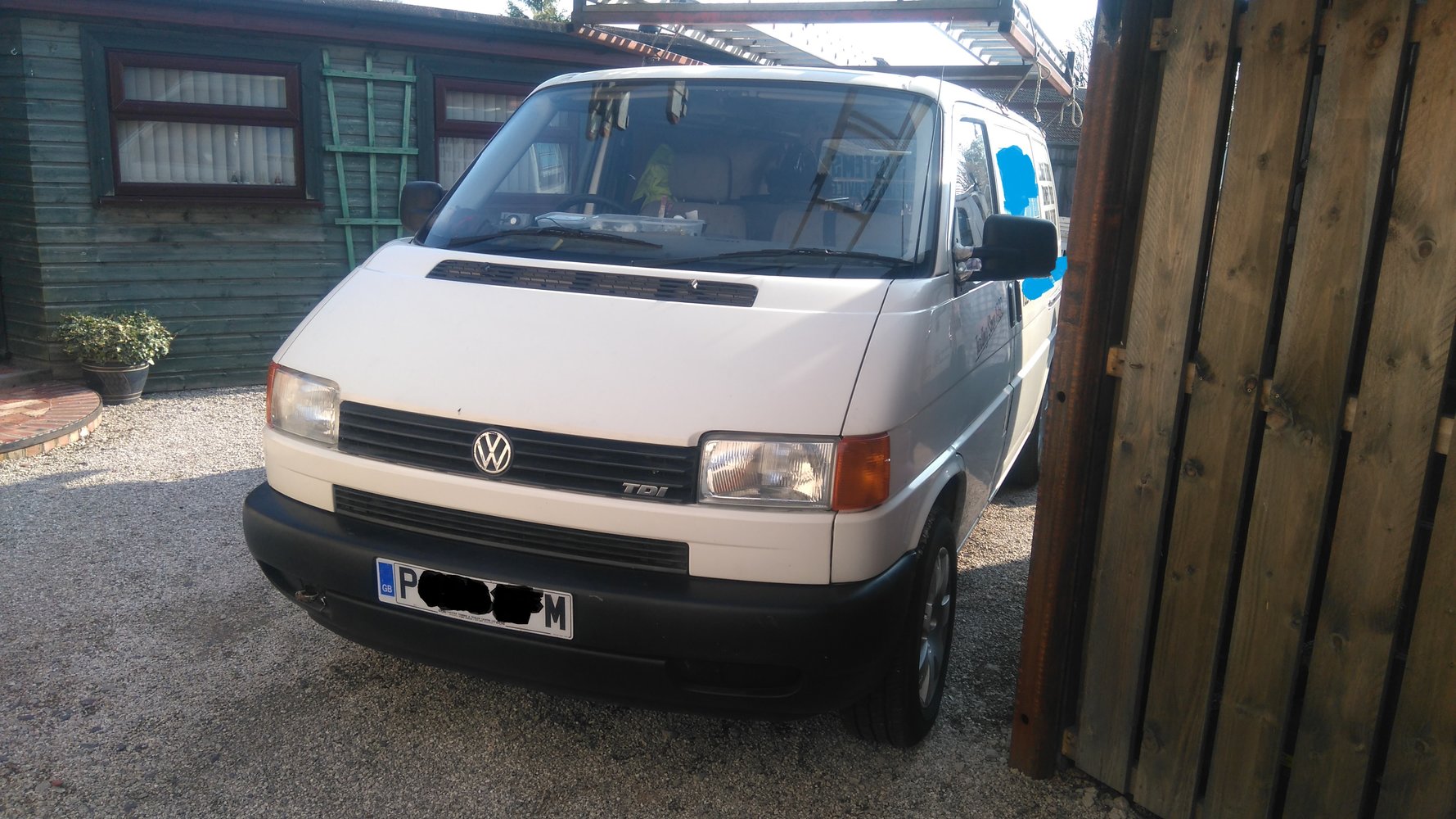

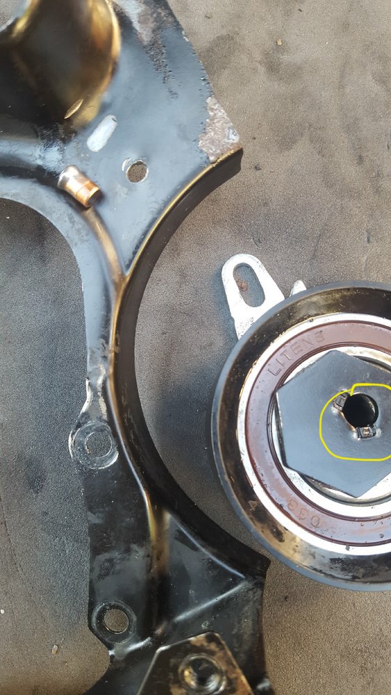

On way home yesterday the old T4 started clanking big time, so stripped it today to find a rivet that holds the cambelt tensioner in position had fell out. Going to weld a stud on the back plate tomorrow and just pray the valves have survived the abuse
Although i don't have much hope. Volkswagen your design sucks..why not a dowel going into the block ??
