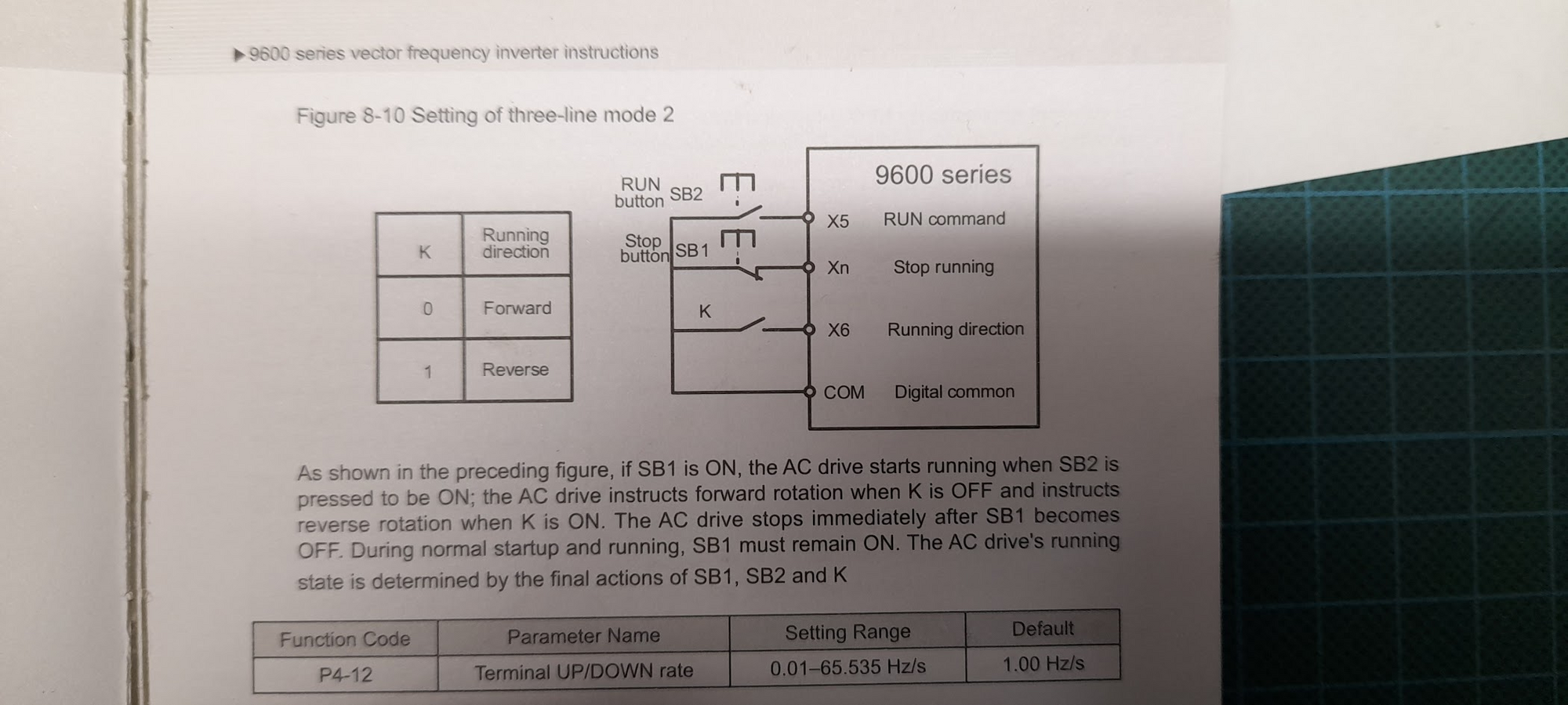

I have enabled "3-line mode 2":
My remote control uses a normally open switch for the run command and a normally closed switch for the stop command. I have a SPST latching switch for the running direction.
When I press the run switch (close the switch) nothing happens. I have checked the wiring and it is correct. Presumably I have missed a setting somewhere????
For a sanity check, I also tried two-line mode 1 as shown in figure 8-7 and this worked as it should.
