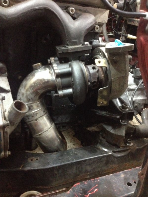

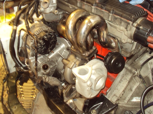

After being motorbike-less for the first time in 12 years I decided I need a new hobby/fad!

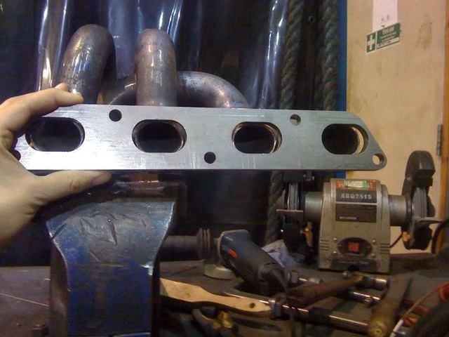

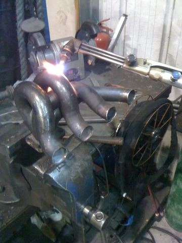

I've now turned my attention to my cherished rover 600 turbo (yeah, rover ... I know), now the lads on the rover site have a trick that saves us about a grand on the bespoke stuff.. Use a far more common and cheaper nissan 200 tubular manifold , cut off the flange and manipulate the header pipes to fit a rover flange. ( same goes for the outlet elbow ).
Please recommend a mig that will handle welding of a 10mm flange. All searches lead to clarke, but there's so many options, the choice is already putting me off. The boys on rover-tech are recommending some very costly kit, I've a limited post Xmas budget of £250 (max)...HELP!!!
