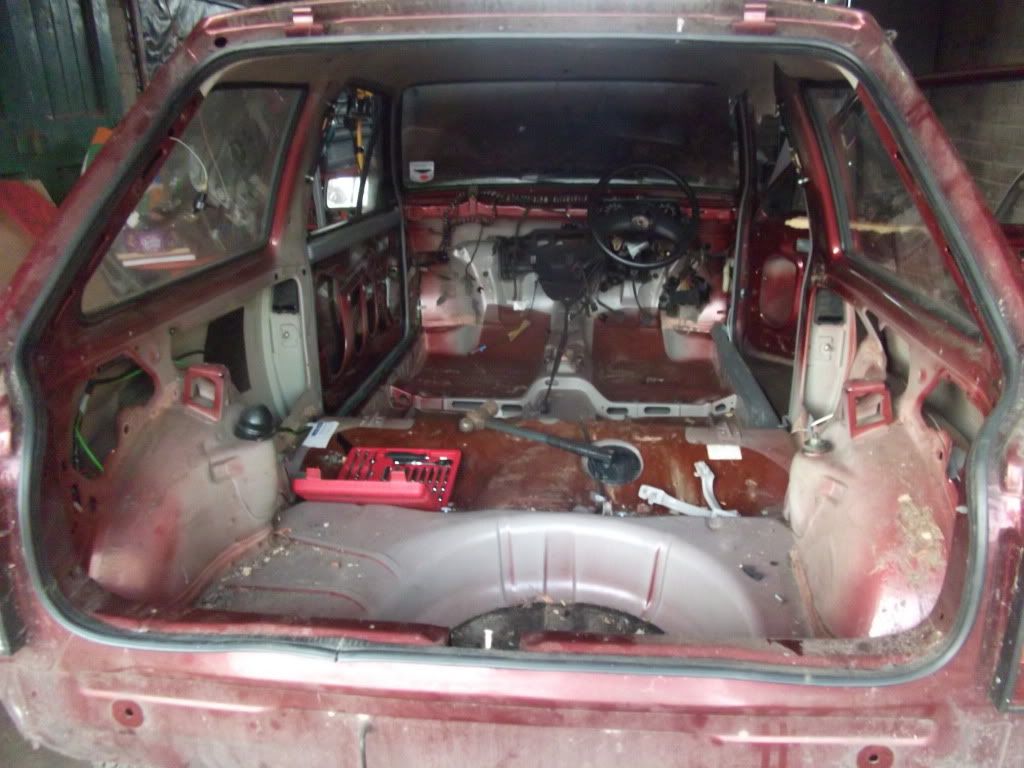

hi all im jake & im 18, i do the ABC lvl 3 diploma in welding (mig tig & arc) at college and im on my final year at night school doing it. I work on a farm full time but hope to get into the industry once ive got the last bit of my diploma. thought id' share a few pics of my nova turbo im building, was only ever meant to be n/a but ive had numerous ideas as ive gone along, as you do!

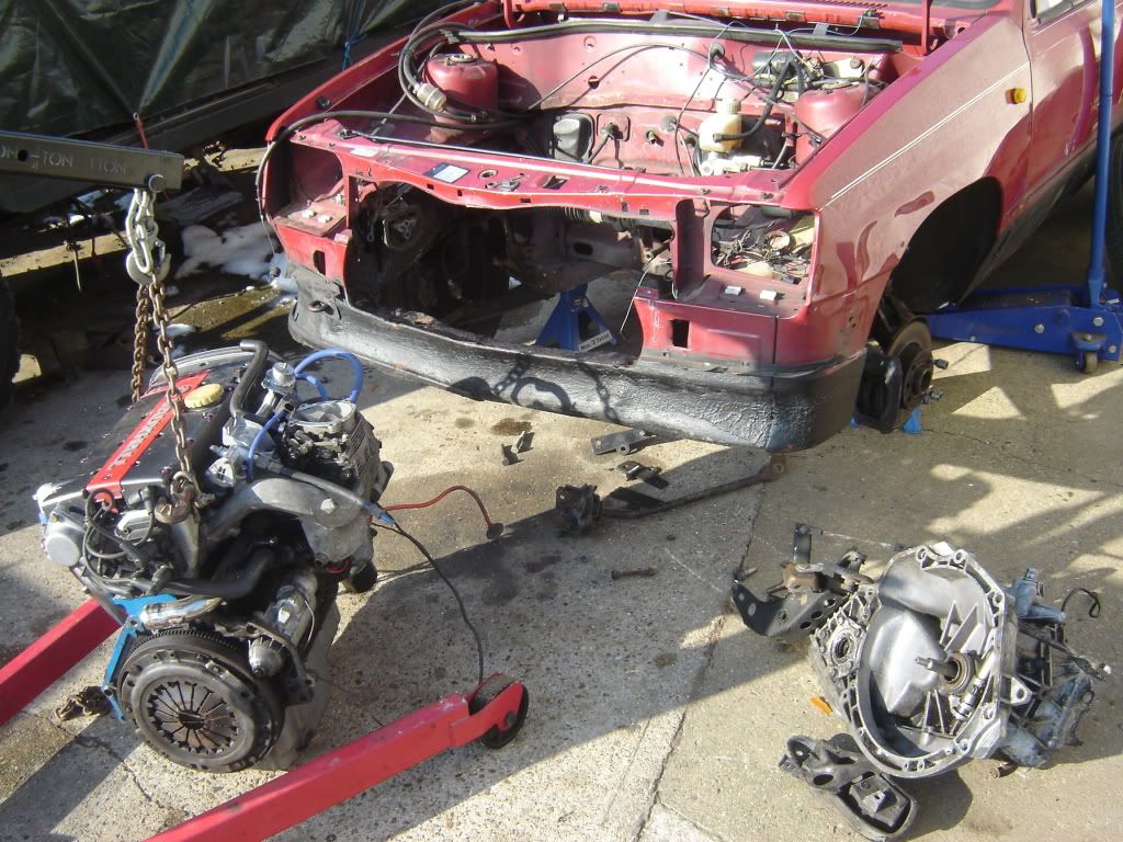

how i first got it:
started stripping:

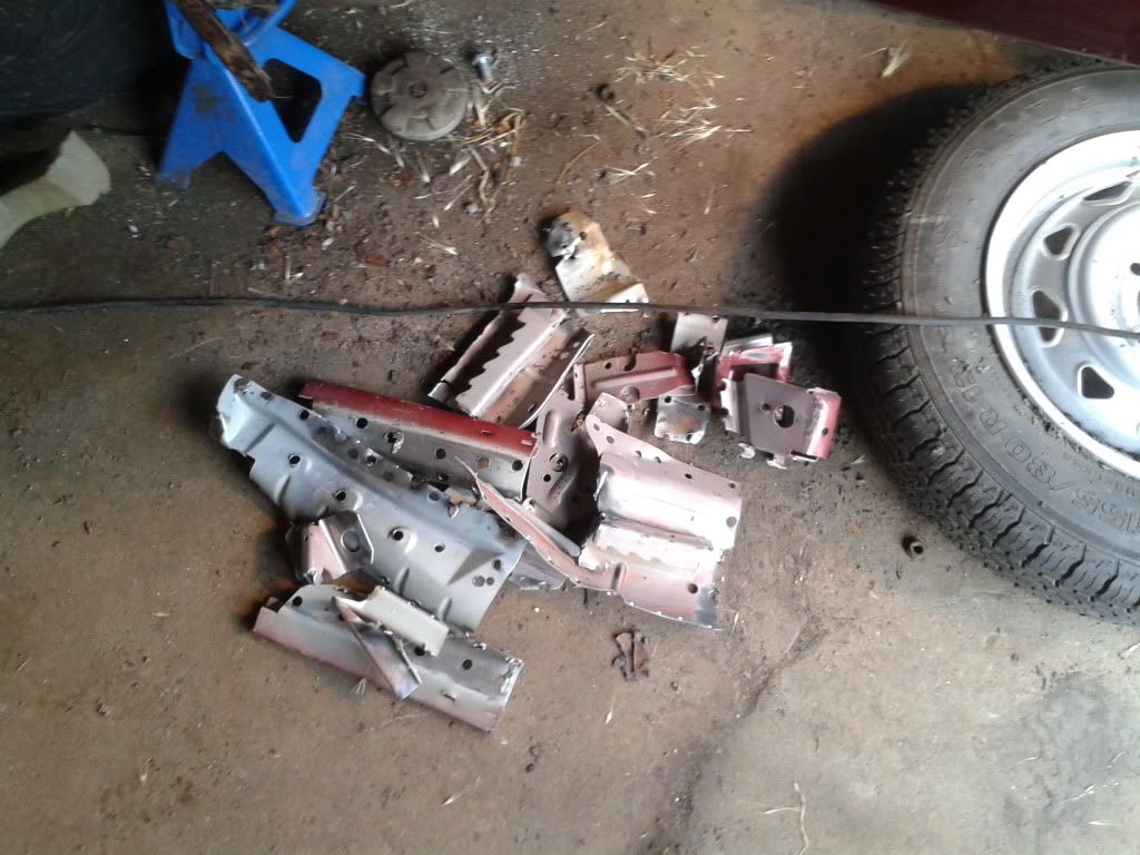

i then aquired another right p o s nova for £300, took the redtop out and weighed the rest in for £130, which makes for a rather cheap redtop

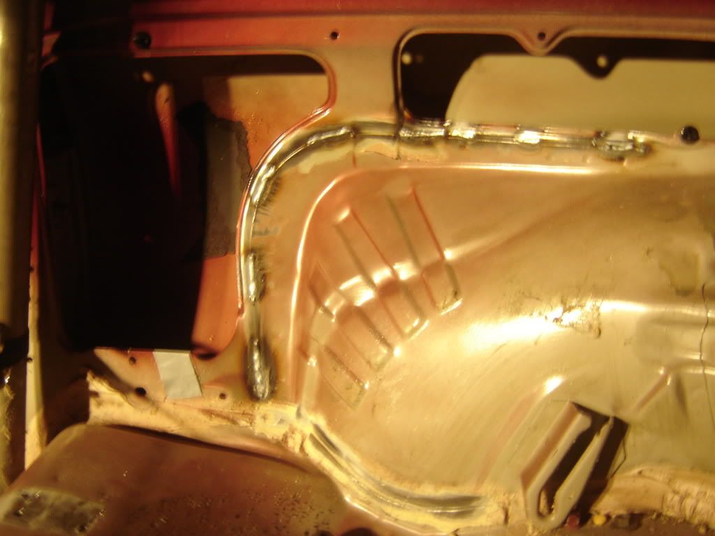

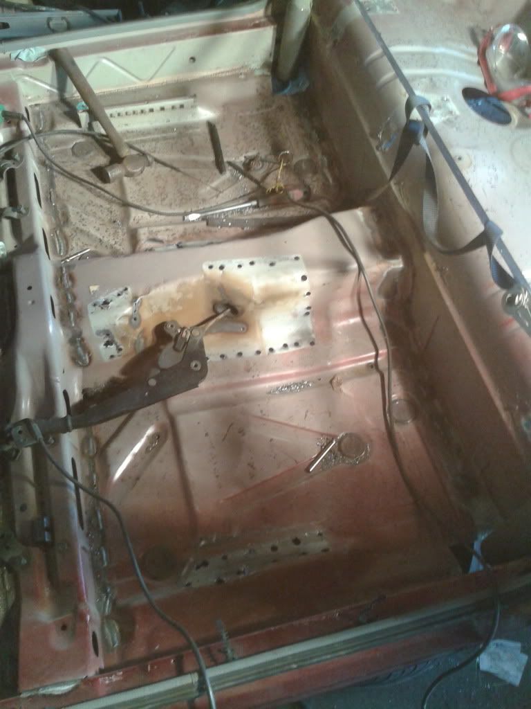

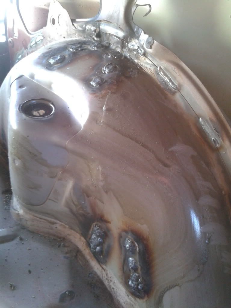

then stitch welded the whole shell, not many pictures though as im not very good at thin stuff im used to welding 3mm+
seat brakes all out and holes welded up

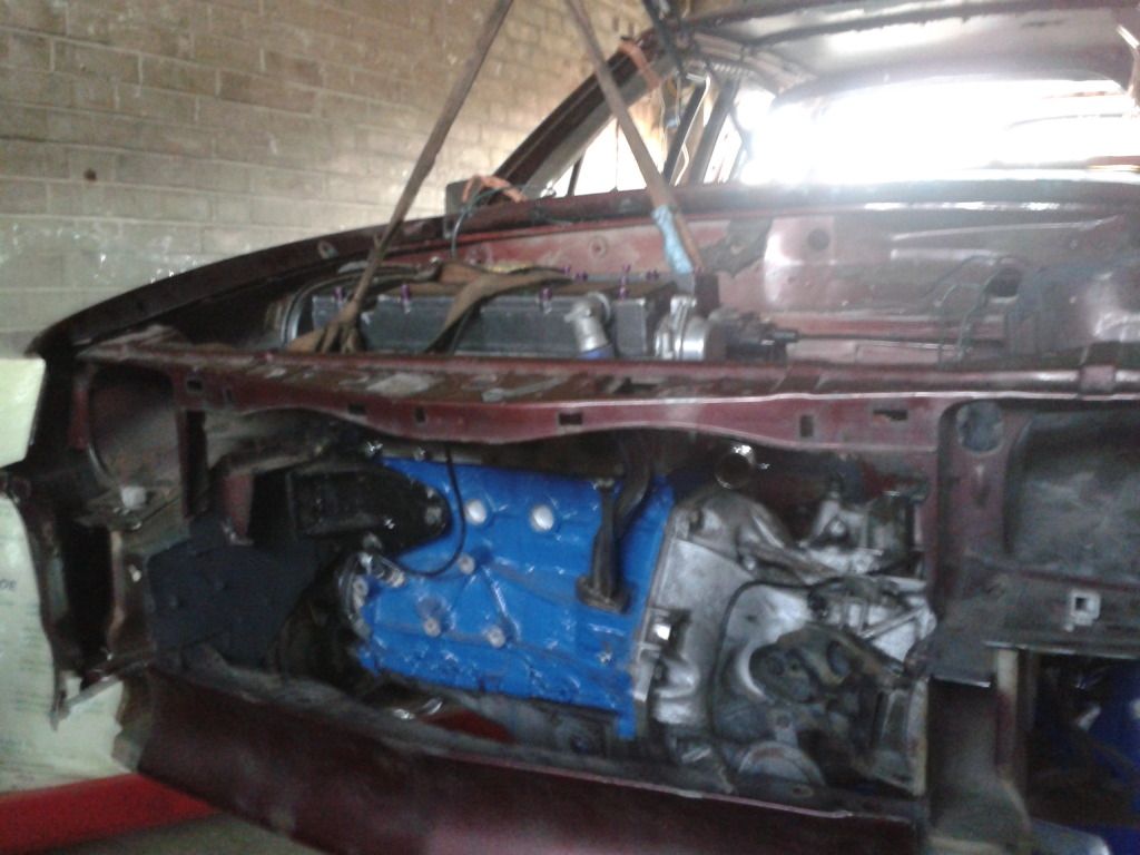

engine in:

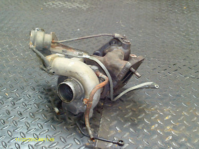

bought a TD05 off an evo 4:

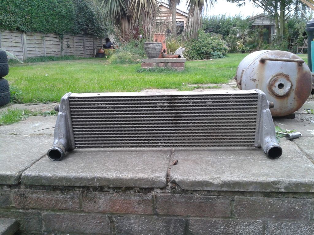

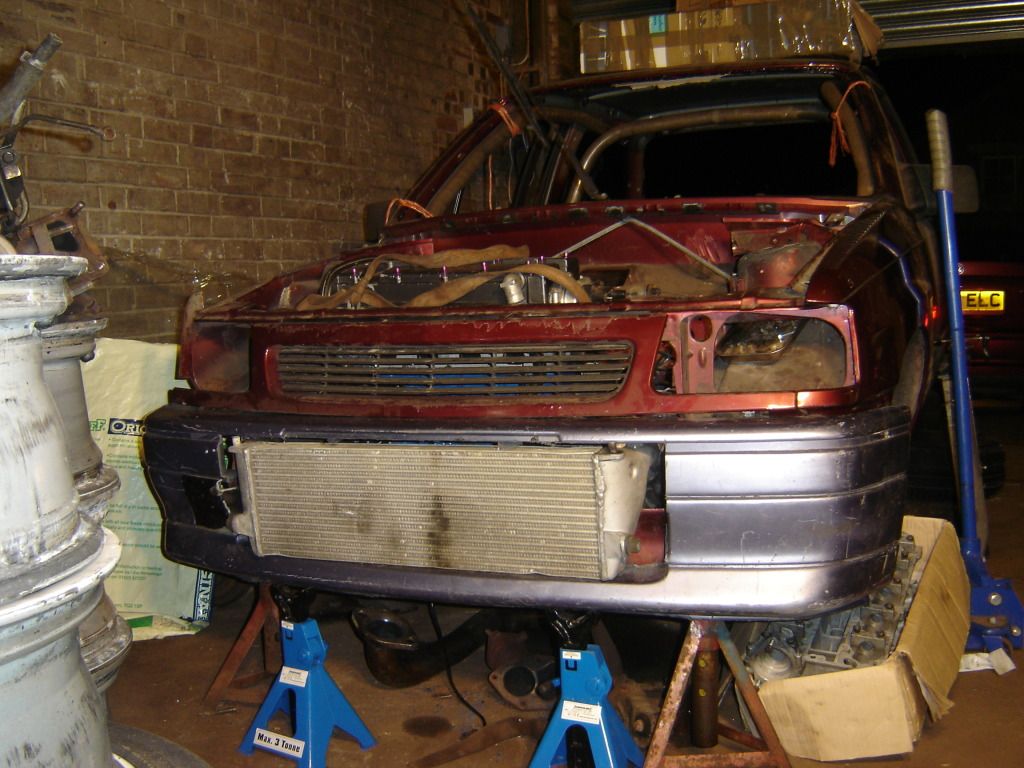

big intercooler off a 2.3 diesel frontera:

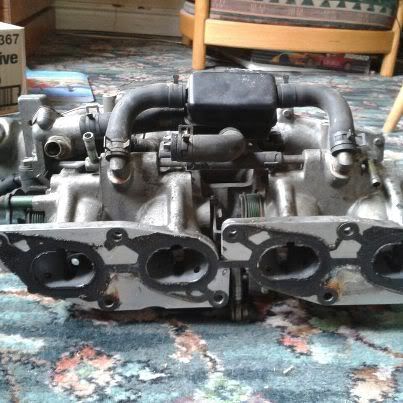

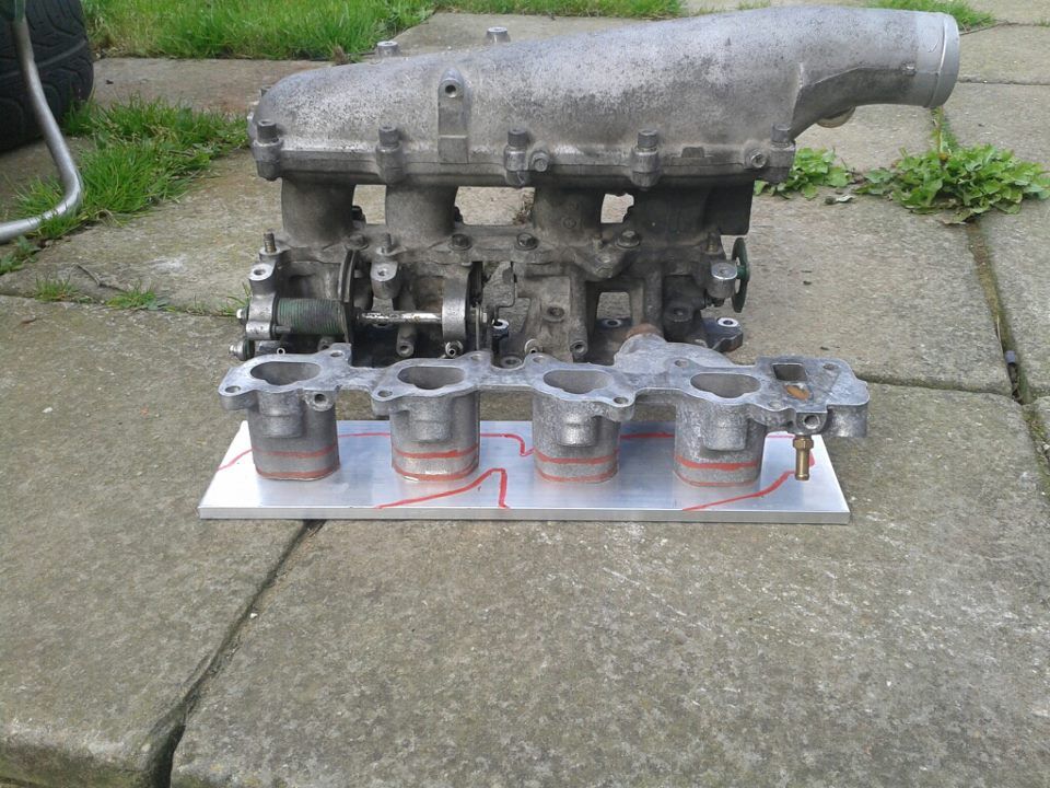

some throttle bodys and plenum from a pulsar gti-r
im still yet to finish the inlet to get them on the head

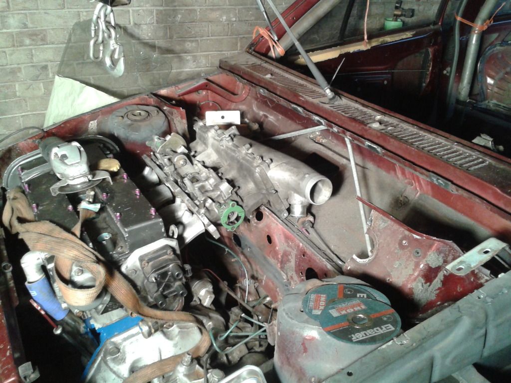

had to cut the firewall out to get them in too
will cut the rest out when the engines out
not much room between the turbo and rad, but i do have the wrong engine mount at the moment so its sat too far forward
went back to ebay....

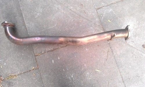

£93 later and i have a really good nick evo 6 turbo (slightly bigger than my evo 4 one) and a evo 8 hks down pipe to play with..
cut up a GSI spec front bumper and mounted the cooler roughly roughly
