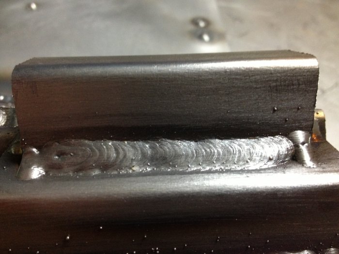

Been practicing for a couple of months now mainly 1.5/1.0mm steel as I will be mostly using this for car body repair work. I´m reasonably happy with my welds now - they seem to pass the hammer test and don´t look too shabby. I have a question regarding tack welding before running beads. At the moment I tack each end of the joint before running a bead. Should I grind back the tack on each end before running the bead? At the moment if I start the arc on the tac weld I get an ugly lump at the beginning of the weld and the end. If I start the weld just at the edge of the tack I get a small gap - see picture. Whats the accepted method of doing this - any other criticism or suggestions welcome.
