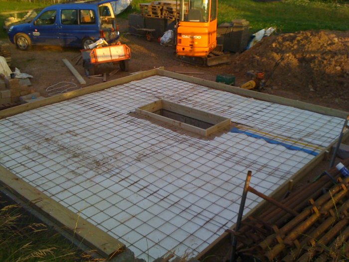

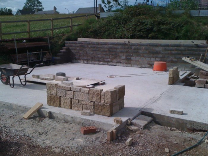

After renting a shed 5 miles away at £960 per year for the last 11 years, I have finally started to build my own at the bottom of the garden.
Phase one is a 6m x 5m garage with attic trusses. My garden is terraced and it is possible to walk into the upper floor from the lawn. There will be a space saver staircase installed in the future.
I am currently at the wiring stage although I have moved out of the previous workshop and the new one is full to the door.
Can anyone advise? I have come upon second hand armoured cable which at 60 meters is just long enough for the job of connecting the workshop to the house. It is 4 core and embossed with 2.5mm on it. Is it possible that this is the diameter of the copper cores and the not surface area?
Also, what cable should I be aiming for if the above is unsuitable? I would like a 13 amp ring main, lighting circuit (1200w max) and dedicated 16amp welder socket. As mentioned the distance ia about 60 meters.
More pics to follow, thanks for now.
