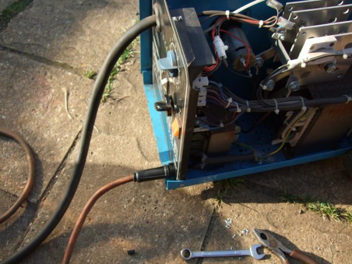

i used a 10-25 dinse plug and panel socket, 200Amp clamp and a small wire lug for the internal connection. the cable is a piece i already had (being green and recycling

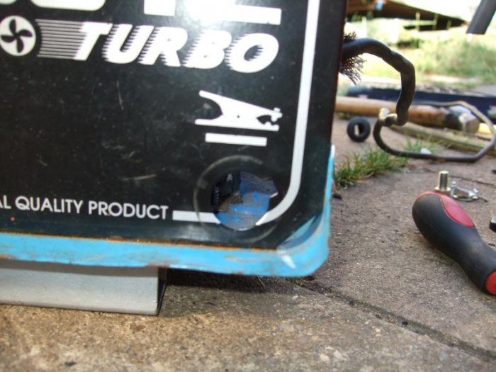

1st pic. usefully the front panel hole is already the correct shape and size for the panel socket to bolt straight up.

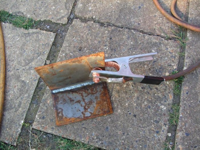

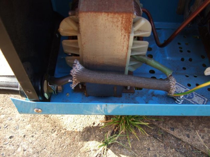

2nd pic. i cut the original cable down to a few inches and soldered the lug on.
3rd pic. new worklead pluged in.
4th pic. the clamp and a quick weld to check it works
i found it makes a big difference especially as it now reaches more then 3 foot
