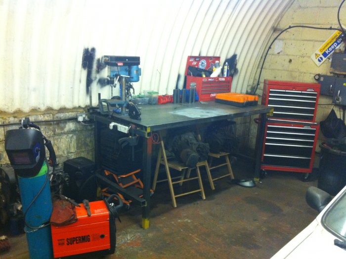

Hi
l am thinking of making a new welding bench as my present one is past its sell by date, the one l have is just a 6'x3' bench with an aluminium top, l want to move up to some thing more sturdy this time, l can cope with knocking up a 3"x3" box frame for the legs/frame it's the top l am pondering, do you think 6mm is enough or 8 or even 10mm, 8'x4 this time l think. l havent priced it yet so might be in for a shock
but what do you chaps do to the top like cutting slots in it for clamps etc to drop into, l was thinking of cutting key holes into it, say a 2" hole with a 1" slot leading of it for an inch or so ??
any one built one or got pics of one ?
Andy
