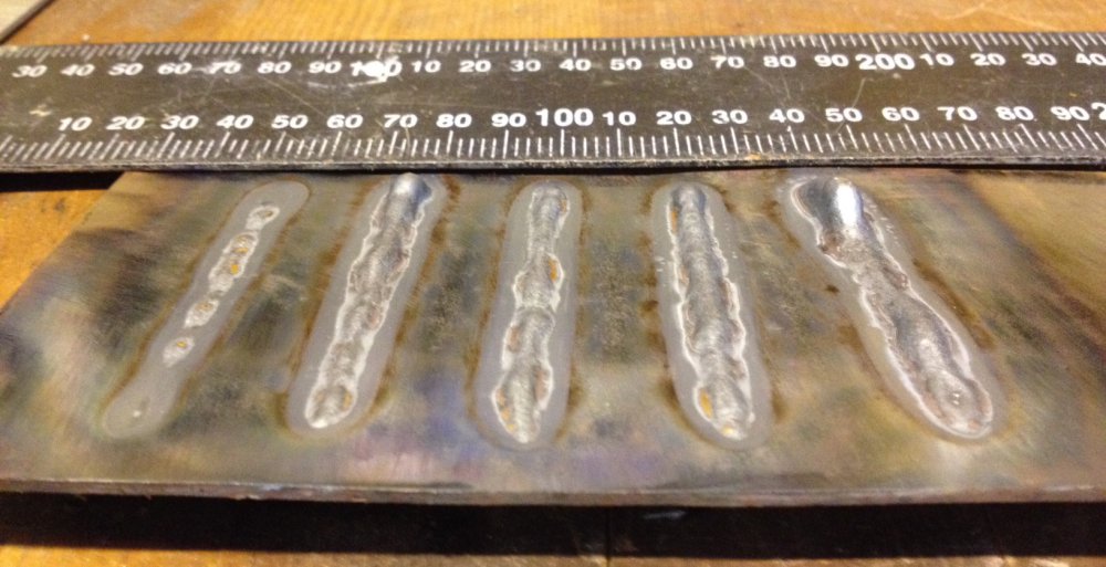

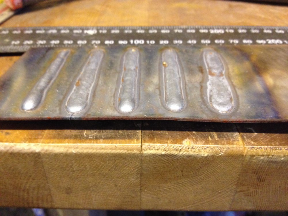

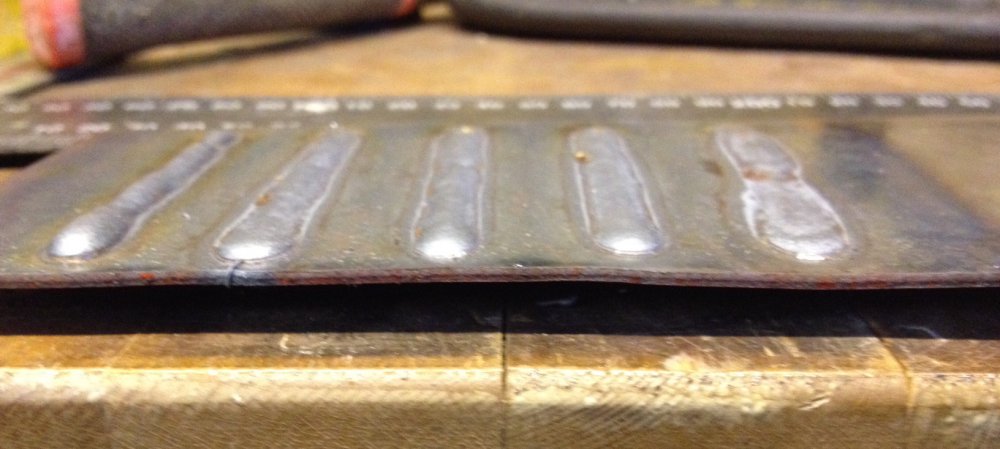

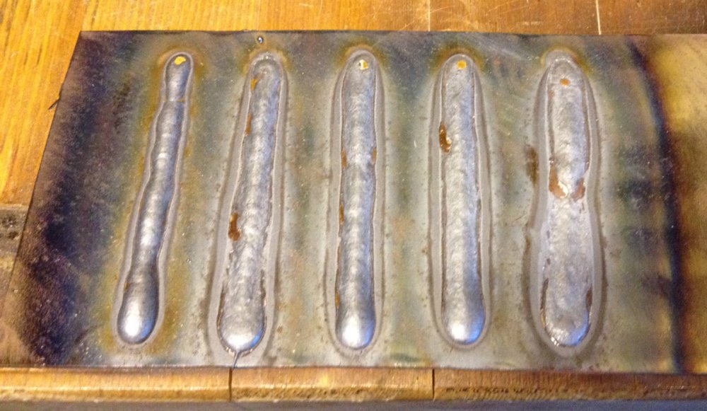

A few beads with an ESAB caddy mig c200i...
The plate is 1.5mm mild.
Left to right, Q Set starting with low 1.5mm thickness (4.5m/min) through to high 1.5mm (5.9m/min) and finally 2.0mm (6.7m/min).
To me as a newbie, no.4 looks best, but I'd really like to hear what you think?

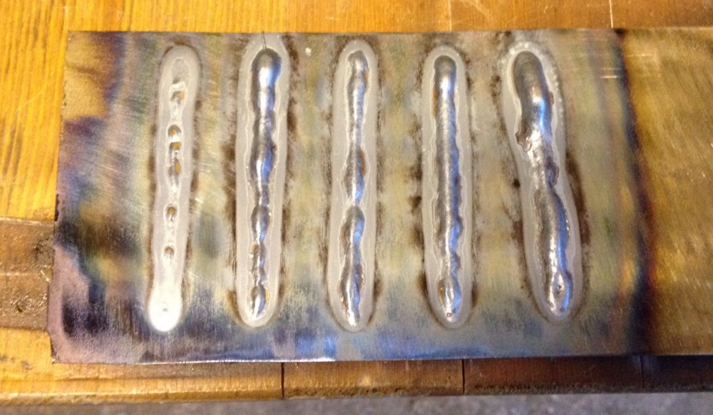

Backside: 1-5 / left-right
Going to do some fillets tomorrow and will post pics.
