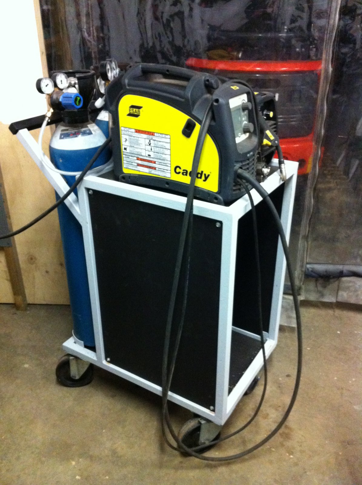

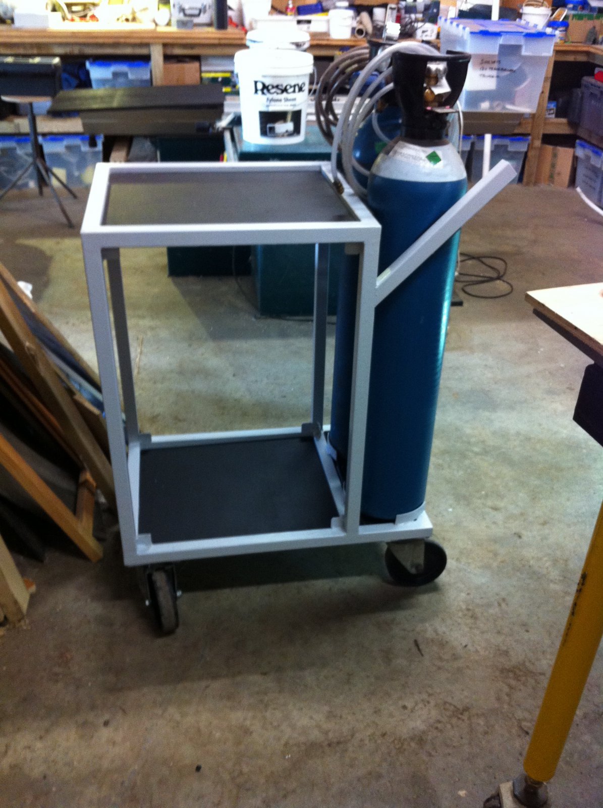

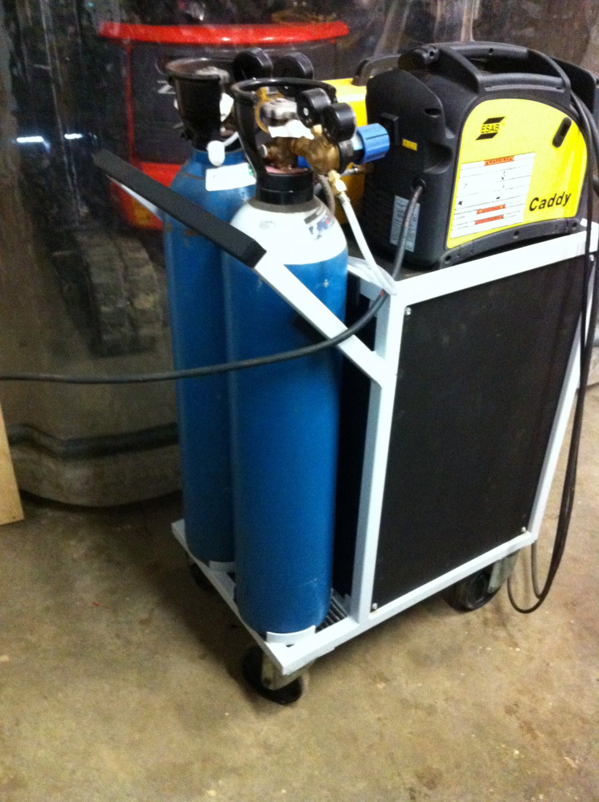

Finally got my a*** in to gear and built my self a welding trolly. Holds 2 bottles and my 2 welders. Just have to put a door and drawn in for the bits and bobs.
Handle comes off so you can remove the bottles.
Made from 32mm x 2.5m square tube, panels infilled with 12mm ply.
All covered with grey oxide paint, which hides the dodgy welding.
