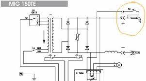

C cag mito New Member Messages 1 Location Coventry Jul 27, 2022 #1 Just bought a cheap torch for my 151te , it has 2 switch wires but the machine has only one connecting to board . I was expecting one. So how do I connect can anyone help.
500e Always buy fire insurance a flood is a hard start Messages 9,373 Location South West Jul 27, 2022 #2 I wire goes to existing connection second to the main feed +. Look at old switch there are 2 connections the wire, and the other section of the SW .
