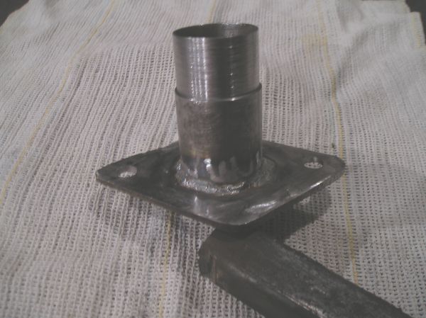

So I had this little job to make a manifold to fit a new Jettex carb, as used on Lambrettas, onto the hovercraft engine (being a Rocker from the '60s it hurts to use something off a tea-trolley!).
I've bought a few tools over the last few months...as well as the gear from Weldequip I got a lathe and a plasma cutter a few weeks ago and this little project allowed me to use most of them.
I found a bit of pipe that was around 2.5mm too big for the carb and used the lathe to thin about an inch at one end.
Then I used the plasma to cut the flange out of 3mm plate.
Finally I got the chance to use the new regulator, with a flow meter (not had one of those before!) and the new auto mask (really nice) if only for a few seconds.
Someone mentioned in a previous message about the 'sound' of welding...
I can hear the difference with this new regulator, it was a really nice fizz without the 'popping' I had from the old one!
Anyhow, here's the manifold...
as an idea of scale, the bit of box it's propped up on is 20mm.
Regards
Peter
