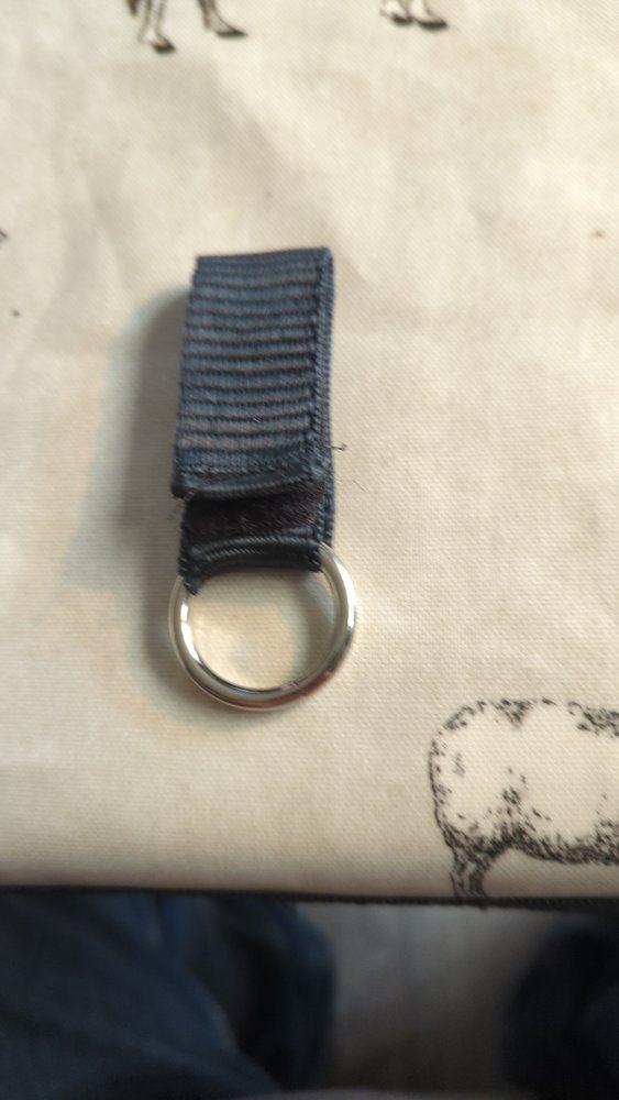

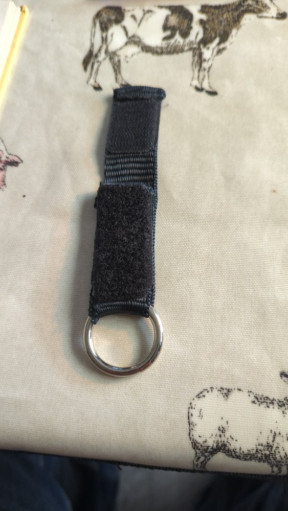

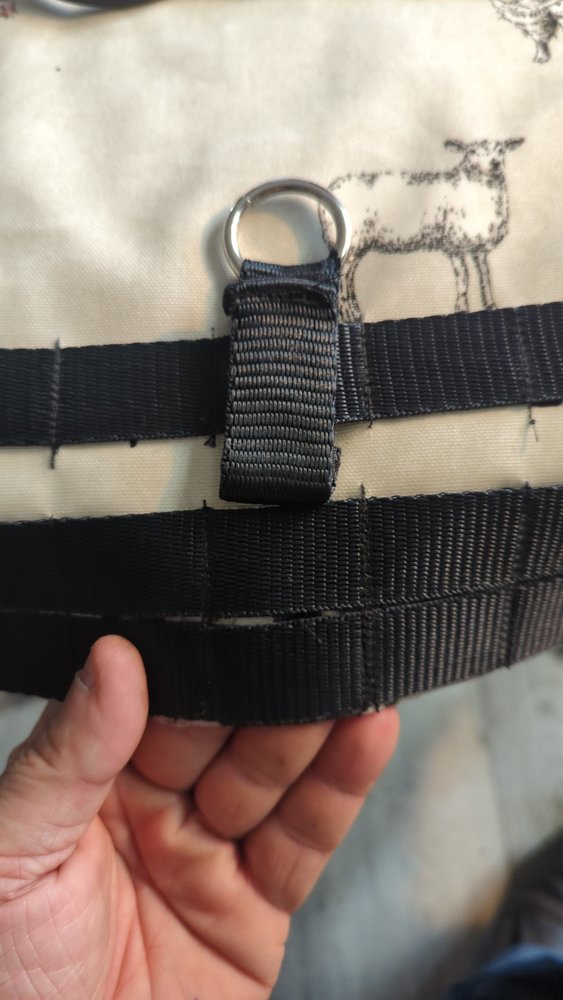

The basic idea is a 1.5x1in / 40x 25mm grid on each item that you want to attach together, then you weave a piece of 1in strap between the two grids to hold them together.
But with a bit of thought, it can be used in a lot of other ways.

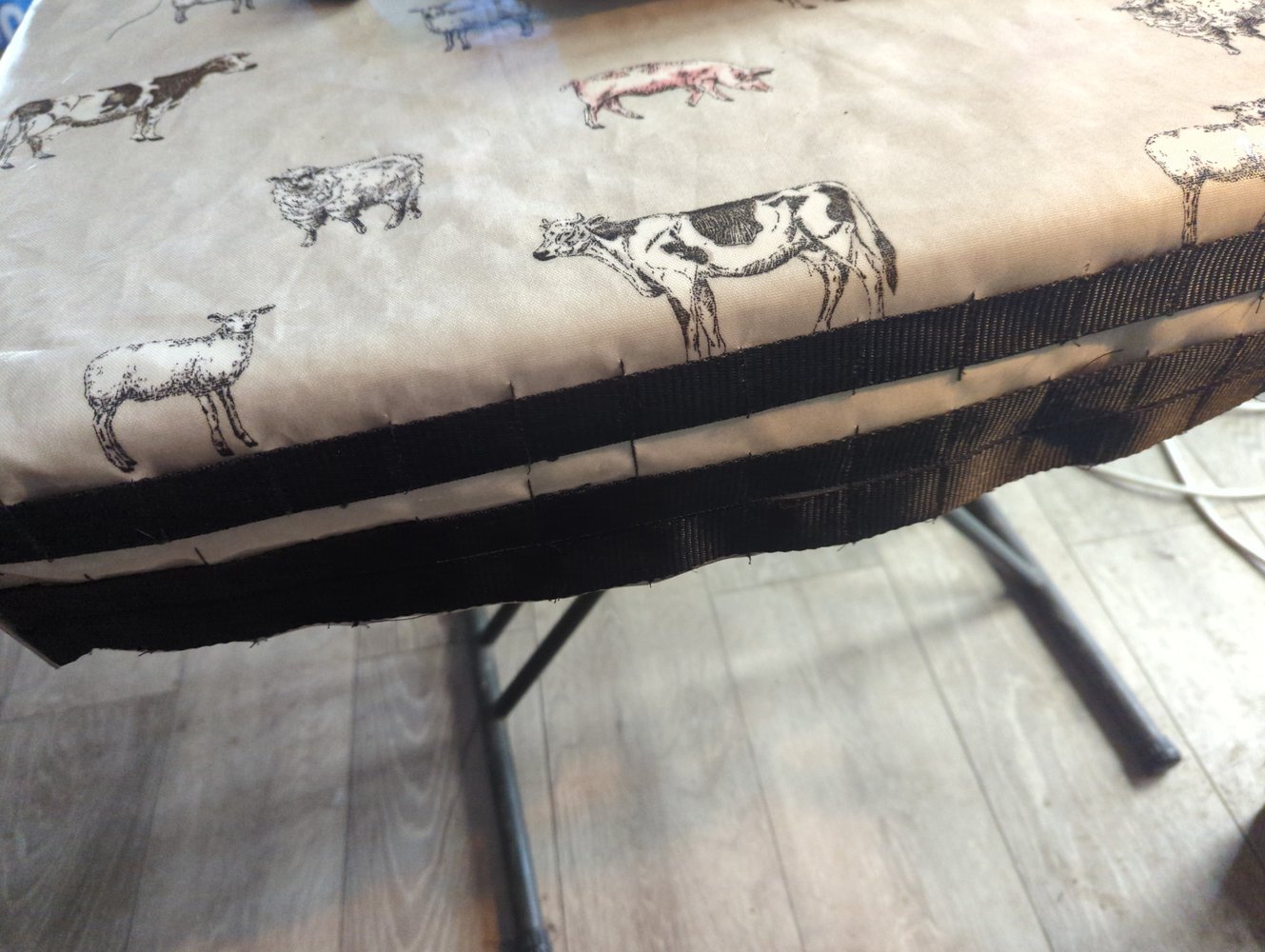

) I made a table cloth for my small craft table with ribbons sewn around edge:

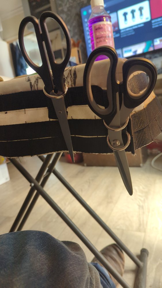

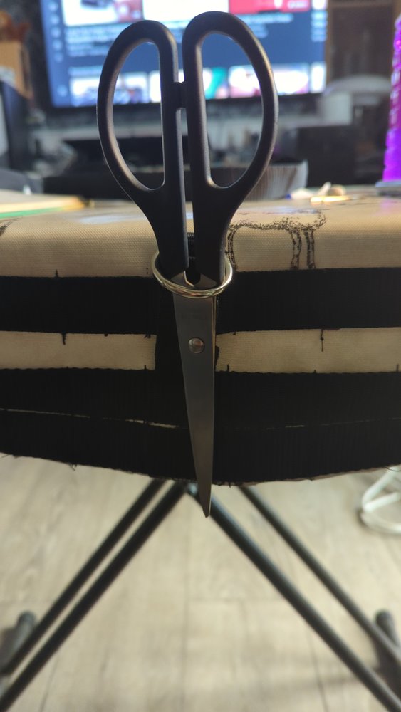

Then I made this:
Obviously, could be adapted to any size/shape of tool, and weldmesh could be used as the "grid"
I'm thinking a pair of boards with velcro between - one board attaches to the grid, the second board could hold a small tool kit.
The velcro lets me move the tool kit easily from work space to work space, and the "grid" lets me change the place where it actually hangs.
