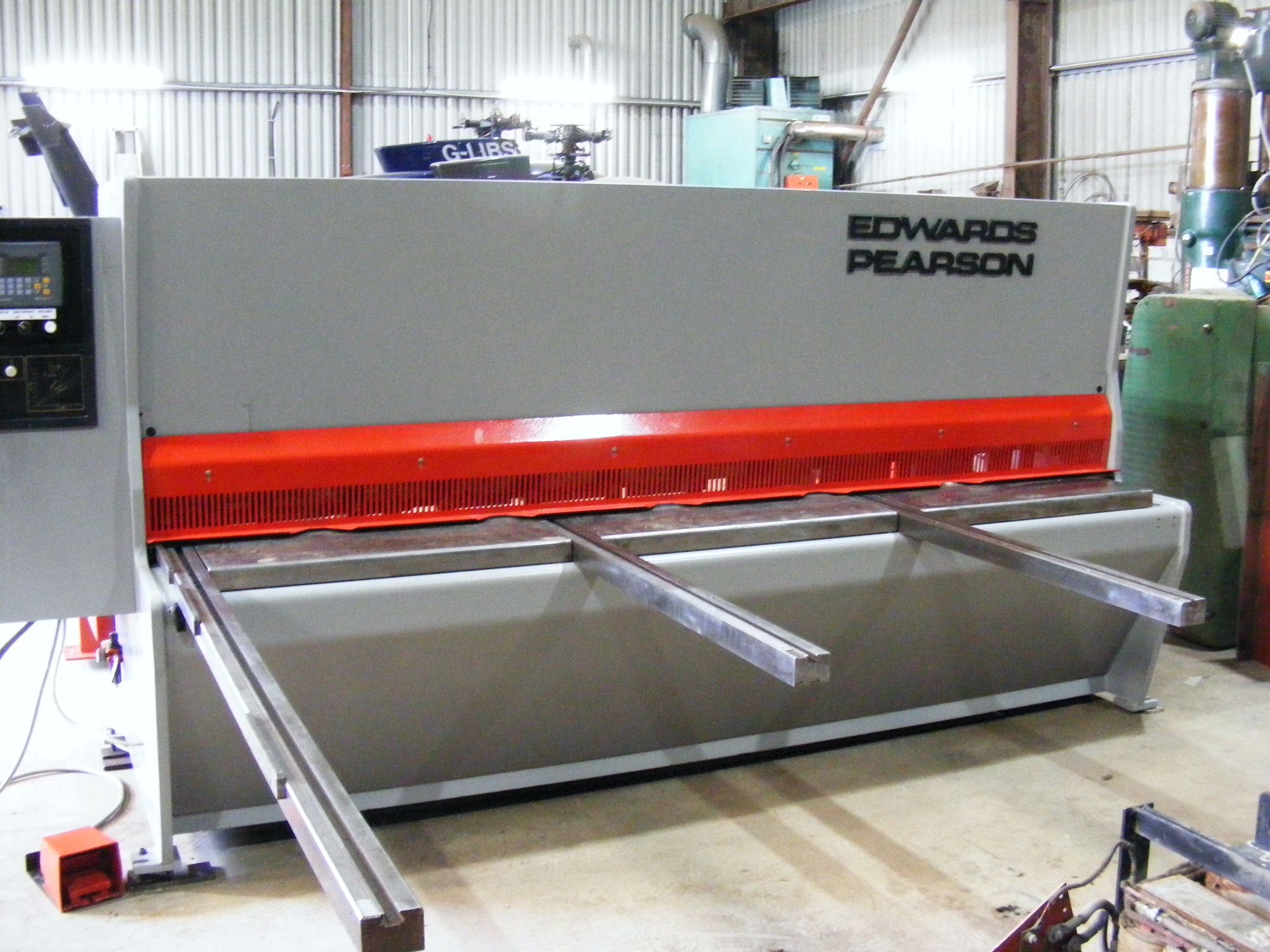

10Ft x 3/8"

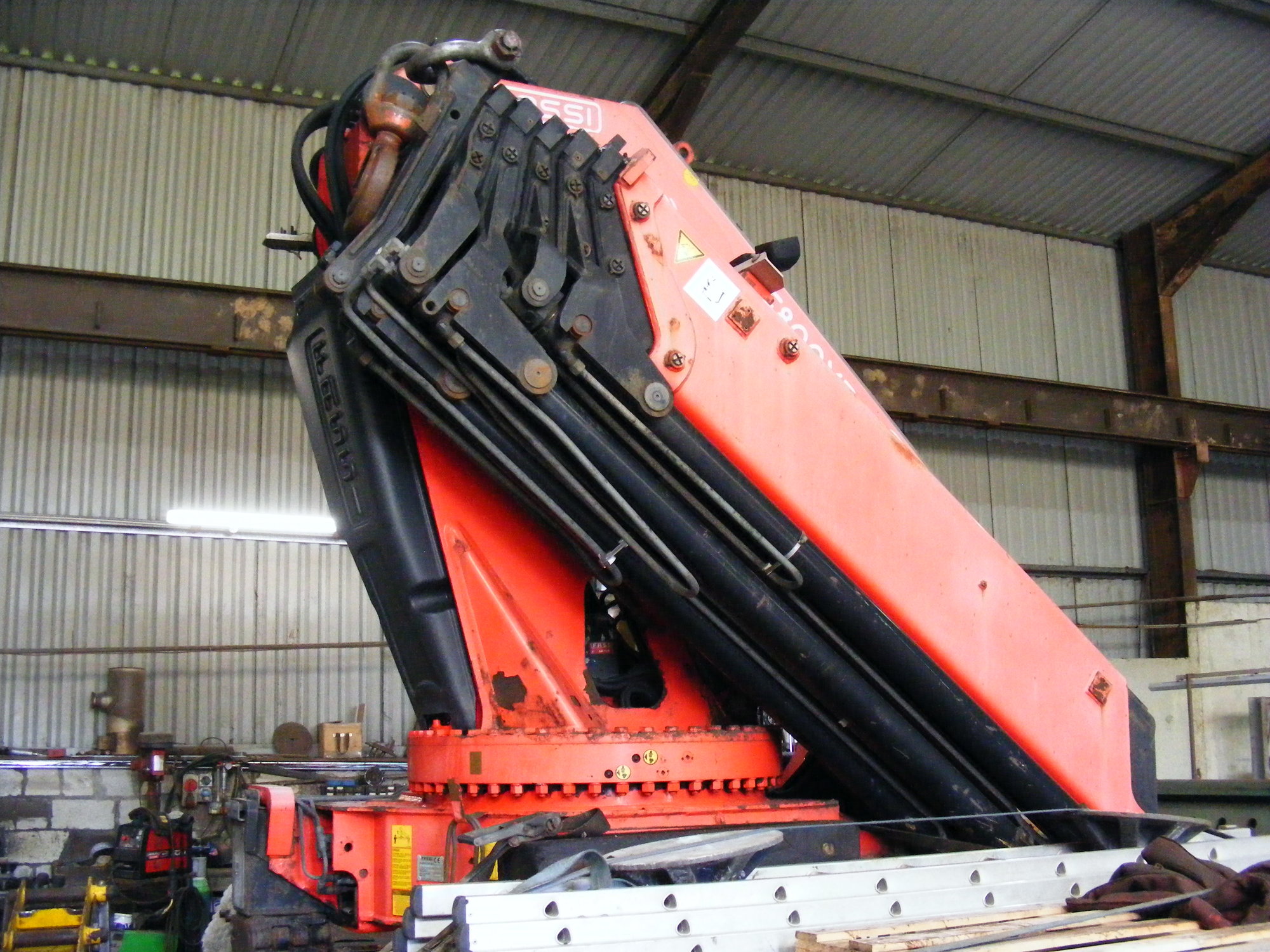

The crane is a fairish beast, I have crane envy as well @8ob

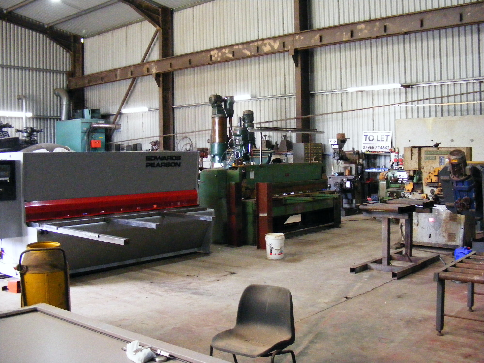

Hope to have it running next week, we have moved most of the kit around to make things easier with less handling, the crane will not have to travel so far, expect we will move a couple of things to fine tune it.
Now we can get the other guillotine's blade & hold down sorted & a new\ re worked tool on the old Pacific B press
You set gauge of plate & it sets clearance then back stop cut depth then press the pedal, (well that's what the book says) there is also an air operated support to stop the sheet bowing on thinner material
It is to go with the NC Break we have
