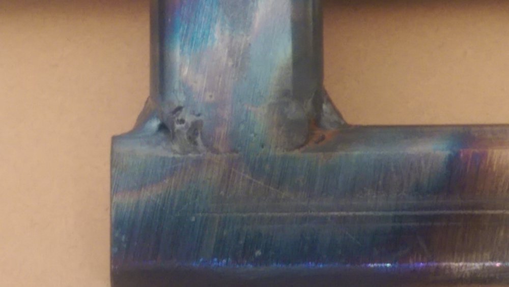

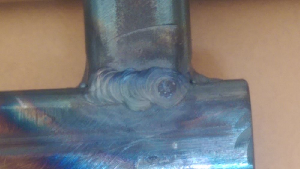

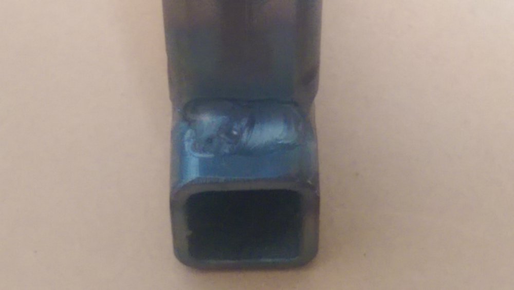

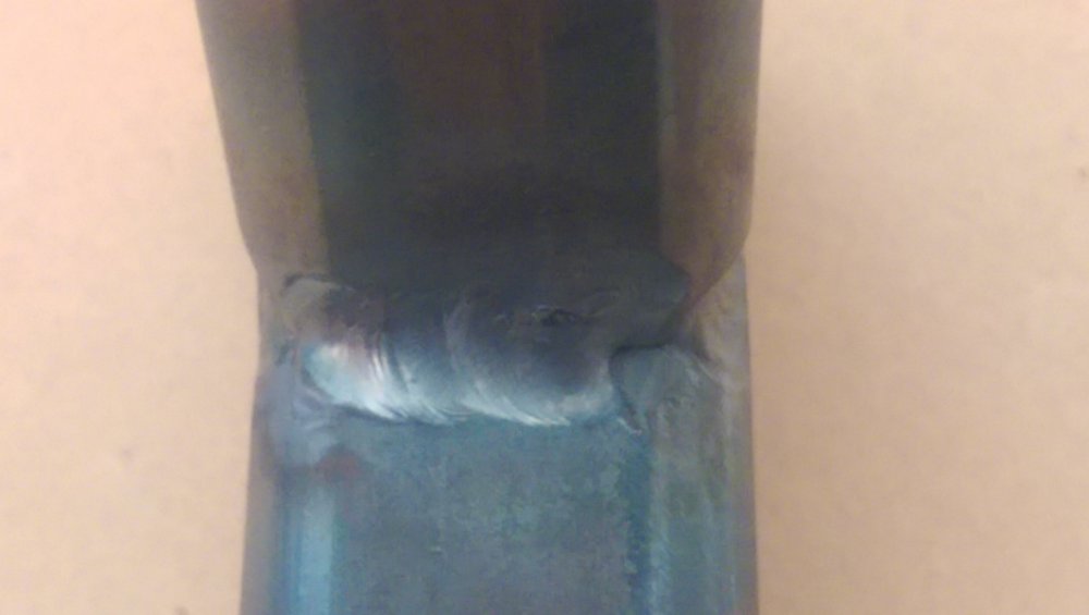

So i have an R-Tech 210ext and watercooler using a WP20 torch
My first goes are on square steel tube
Okay not too bad
This was my 5th attempt
6th and 7th welds

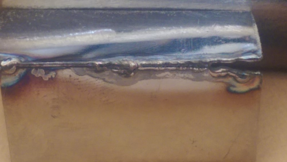

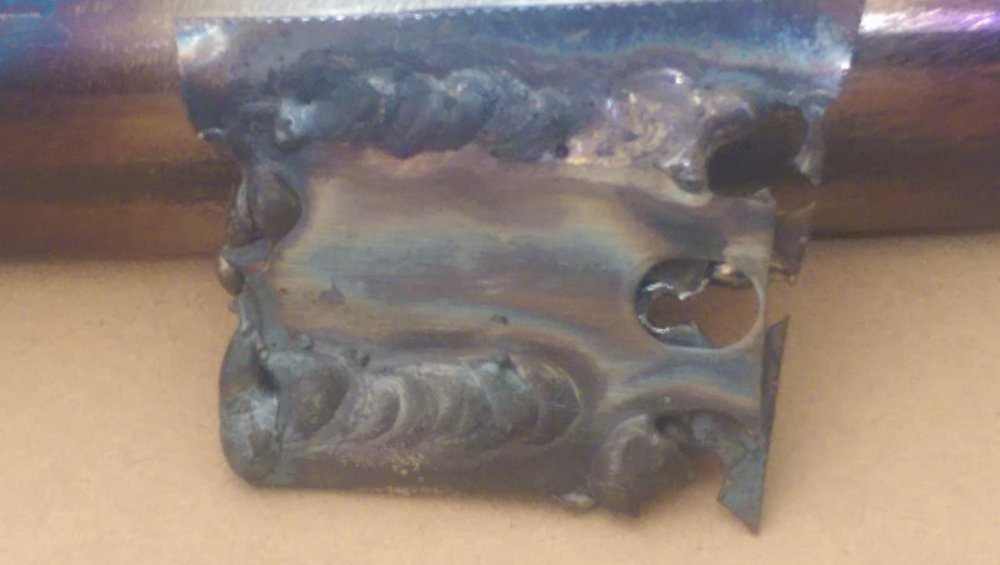

I then had a go at thin stuff 0.6mm stainless
These are beads and an overlap but using 1.6 steel filler as i didn't have any stainless
Okay this is a corner weld autogenous 3 tacks using an angle for support
Starting from the right i had the amps to high 35 and well you can see the result
Dropped to 20 and things went a lot easier

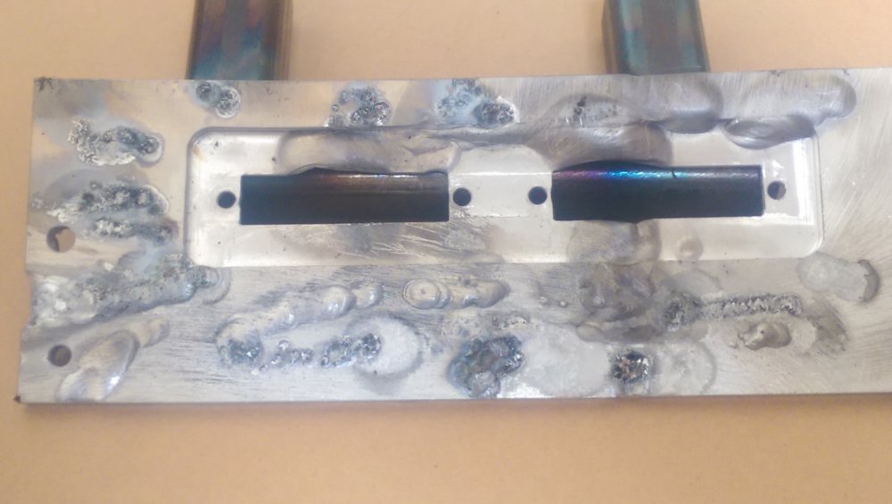

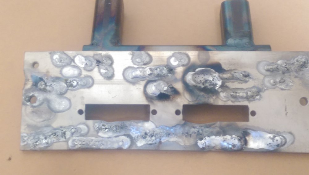

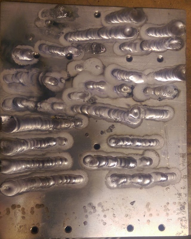

So now time to turn to ali and where it all went pear shaped
Yes well this is where i started looking at threads like "My welder won't weld ali" as neither did mine
but i finally started to get a bit of a bead going
The pictures are front and back of the same piece

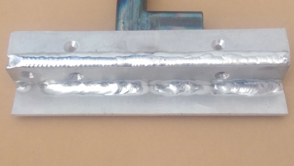

So now to have a go at some proper welding
The top weld was the first weld 3mm plate autogenous at the end i had a bit of a slump then i lowered the amps to 110 from 120
The bottom was the 5th weld using an oversize IMHO 2.4mm filler

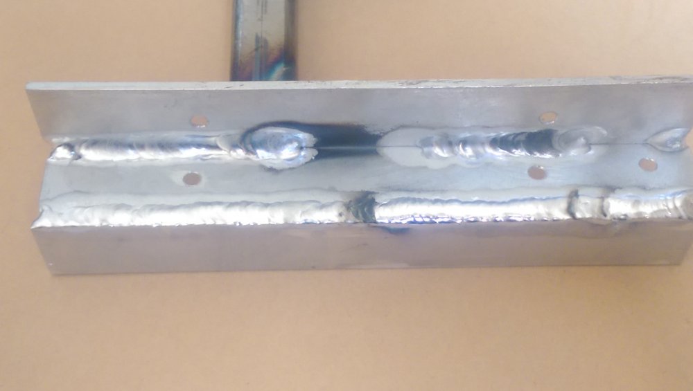

My second attempt was the external corner not all one run but it sorted the slump issue
The top fillets were done with the piece rotated 180 degrees as shown this would be the 4th joint
All the welds well done one after another and the piece was getting a bit hot and my belief why weld 5 fillet was looking a bit saggy
The steel tubing is 20x20 2mm wall
The big ali plate is 65x185 5mm
The other pieces of ali is 3 off 25x180 x 3mm
I await your comments with bated breath
