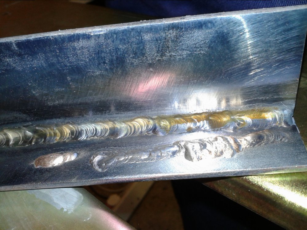

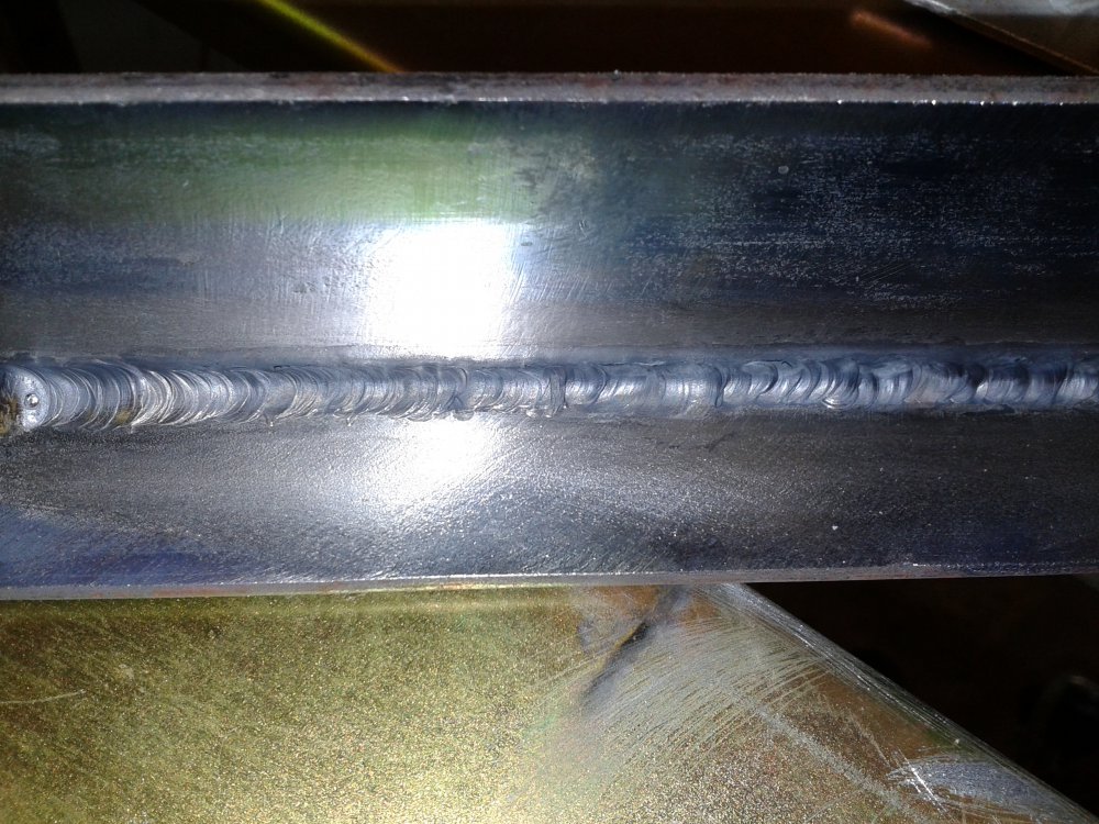

Hello,
i'm new to TIG welding,
i was doing these fillet welds yesterday, is my arc length too long? i was having to chase the weld pool along and get it to adhere to both plates. I struggled to get it to auto weld and the pool to form in the root of the joint without filler. I have a feeling there was too much filler in there.
Welding 3mm mild steel, the steel was pretty clean prior to weld, but was dull grey afterwards (too much heat?) Parts of the steel were cherry red once i finished one of the welds which i presume is not normal for TIG as i am trying to keep a tight arc length and small weld pool?
There is so much going on that i ran out of rod in my left hand and forgot to feed it, so i circled the tip, am i better to just stop the weld, and resume where i left off rather that pouring more heat into the material?
Number 8 shroud, with a purple sharp clean tungsten, 5LPM Ar flow, with 5 sec post flow.
first image is a bit better weld, 2nd image, the weld got far too hot!
any suggestions and tips welcome.
Thanks!
Stephen.
