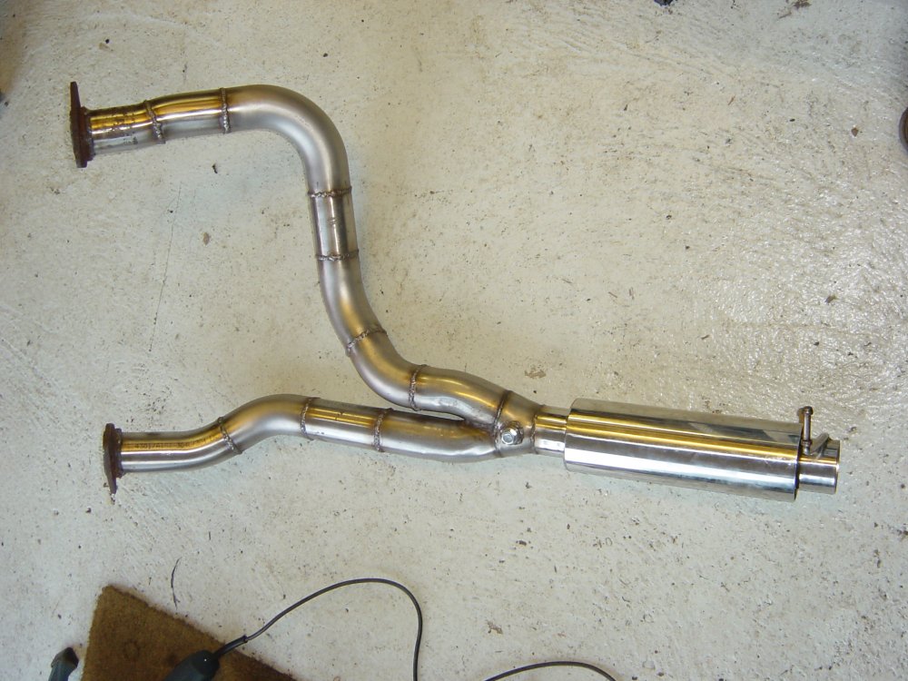

hey lads, iv been welding for a few years on cars, but iv always used gasless wire as my jobs never warranted a gas bottle, iv also had a fair amount of time on my arc welder.
But in now building a custom turbo manifold using 3mm 304 SS butt weld bends and 2mm 304 SS tube, iv also got to weld the SS to mild steel flanges i have a sip Mightmig 105 mig and Topweld 140 arc welder..
Im basically after some help with wire and gas choice, i no welding the 3mm to 2mm with the arc welder will be difficult and probably blow so my only real option is to use my mig or could i get away with my arc, the welds need to be strong for the heat and weight of the turbo i don't won't it cracking.
i believe i need 308l wire for the SS to SS and iv read ill need 312 for the SS to mild steel is this correct??
Also what gas could i use for both the SS to SS and mild steel to SS as this is only a small project so don't won't to have to spend a fortune on gas, so could i use some of the disposable bottles if they sell a gas in a form i could use??
sorry if i have got anything wrong but thanks for any help and advice
