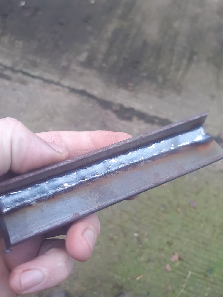

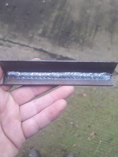

It's only a small 200amp (Chinese via Germany) welderWhat machine are you running ? Wire diameter ?

(sunburnt)Good choice, which model Stahlwerk? I've been looking at this:Sure what's not made in China lol
It's a Stahlwerk welder with a decent reputation/guarantee.
No probs with heat, I'll mostly be using the pulse mode for 3.5mm, and standard mig for .9mm, it's actually quite good on the thin stuff in standard mig.
Hell yeah , I cooked my face a couple of times with pulsed arc , learnt it the hard way , nothing crazy but it would have been better to not experience that .Pulse MIG - my only advice is "cover yourself up".
Yes that's the one i bought.Good choice, which model Stahlwerk? I've been looking at this:

But it doesn't have settings for .6 wire which I prefer for some things so that would have to be manual.
