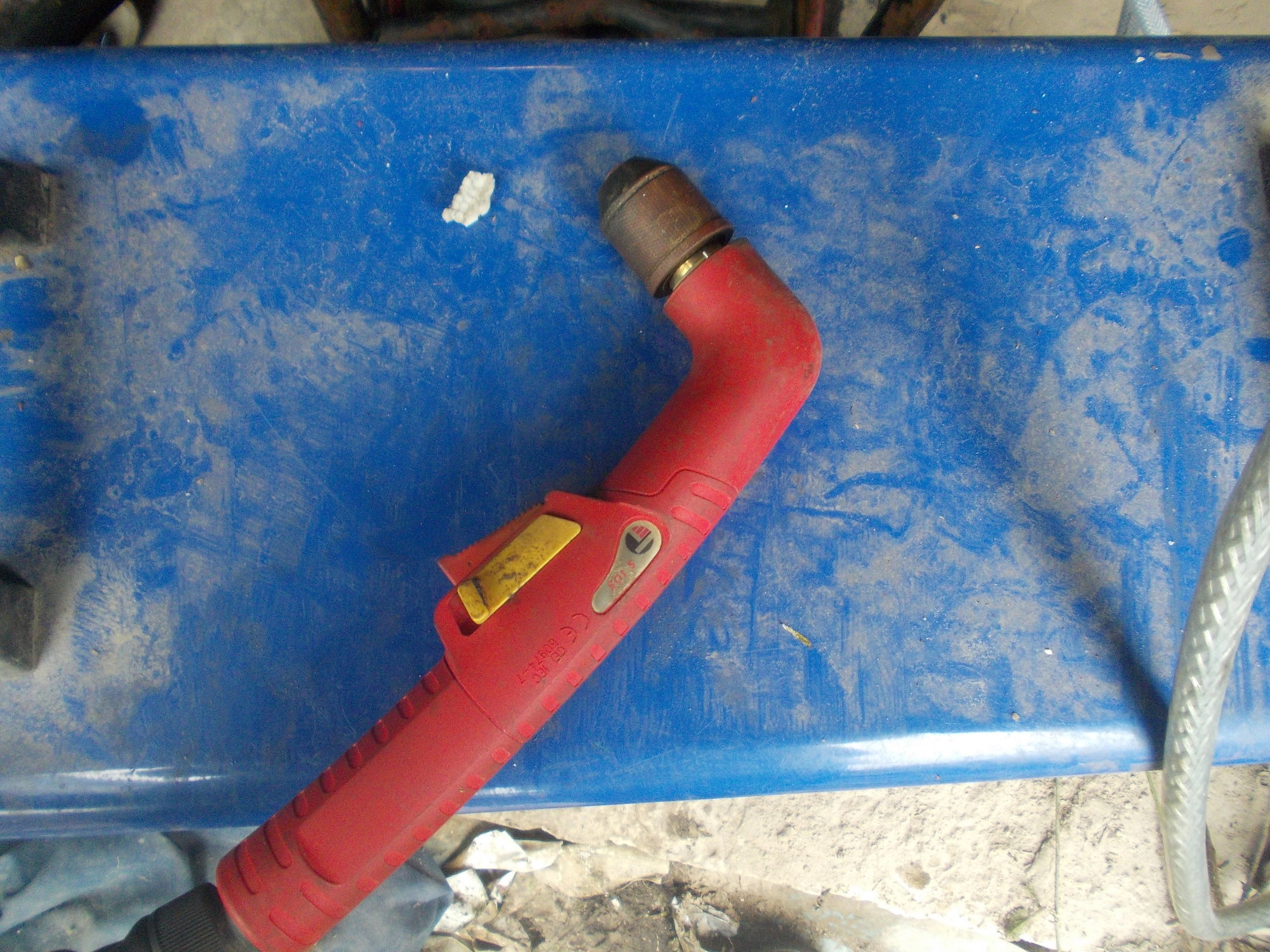

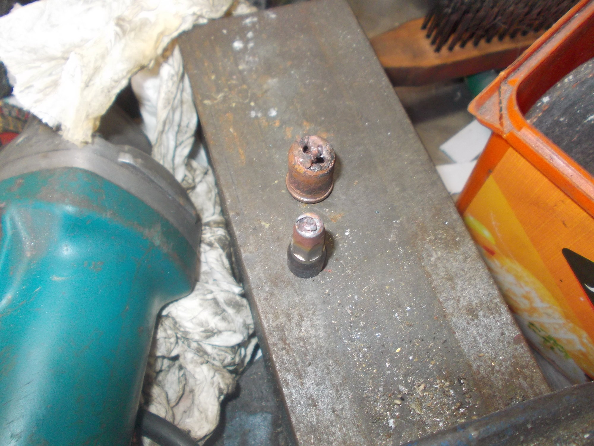

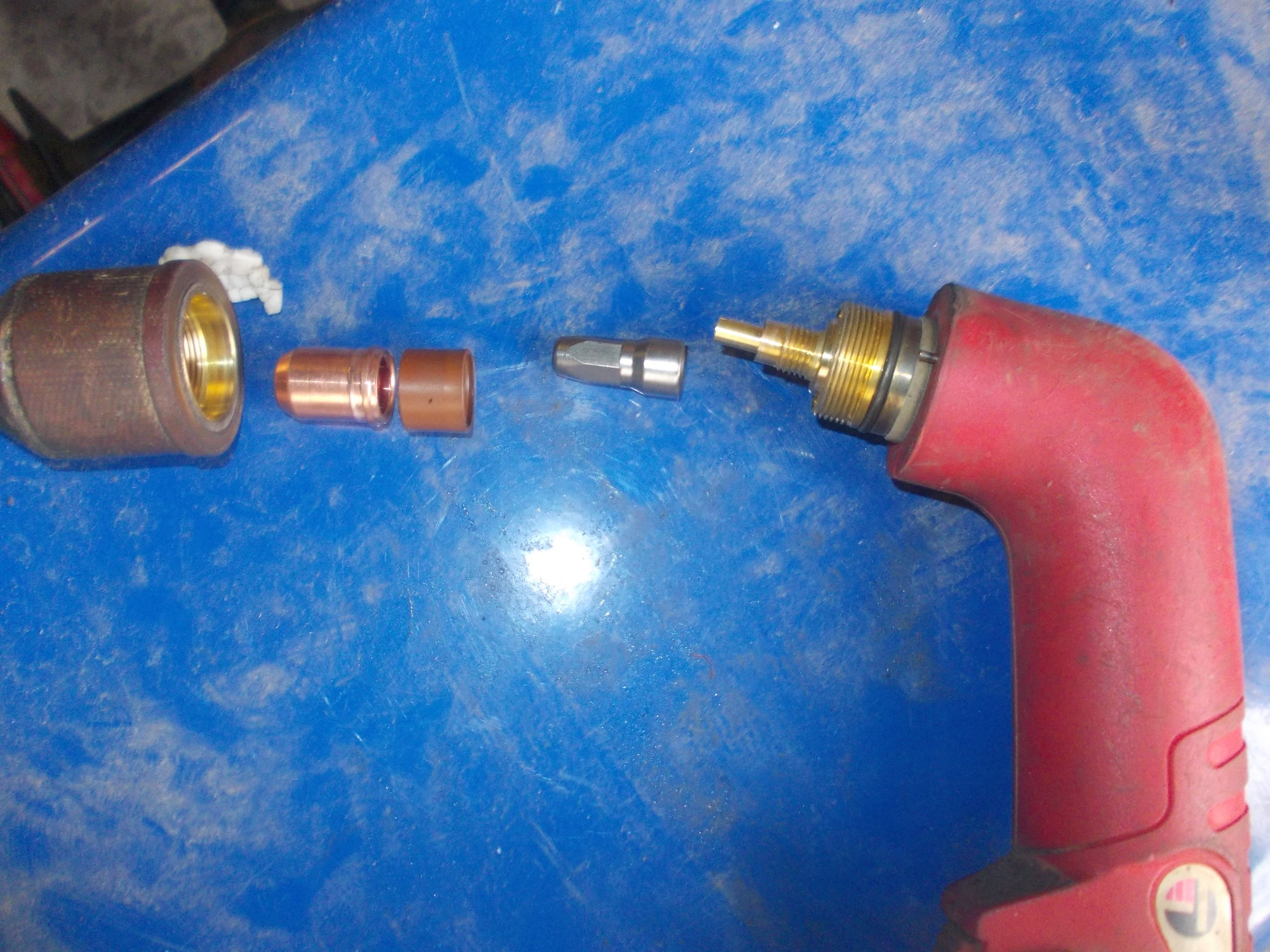

Got delayed with the pictures will post them with more information on the machine tomorrow thank youhave you also changed your inner copper bit
once both have been changed will it light up or not
also you need to say which type of plasma cutter are you using ?

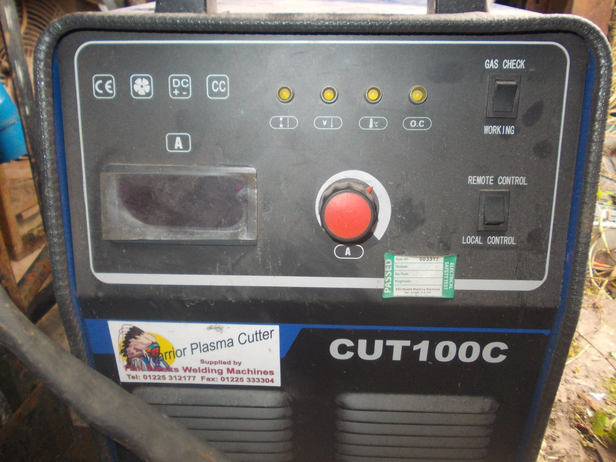

Yes sorted now i think the shroud has lost a spacer ring or something i have now replaced the shroud so it depresses the two pins and it works Well spotted the original shroud will not screw down far enough to depress them i did make sure the new bits inside were the same length as the burnt out ones i wonder if i have dropped a ring off when i removed the shroud the first time trouble is its out side on the grass i prob will never find it thanks for all the help as usual brilliant forum regards andyAre you screwing the shroud on enough? In your second pic the shroud is not down far enough to push the safety pin in. This will stop the machine firing up.

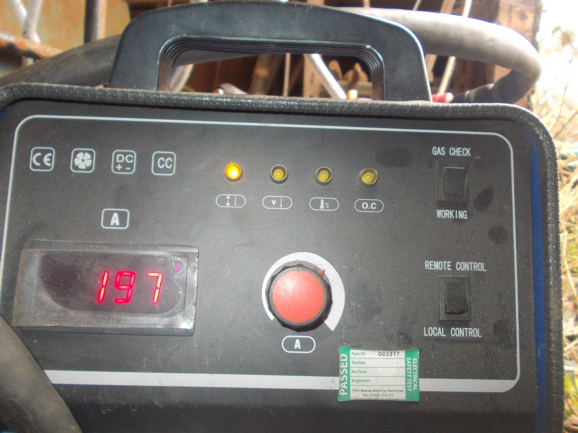

Ah I see you have it fixed whilst I was typingAs well as what @MattH has said a few other observations about your pics.
One is showing an LED for the Air Pressure, I presume it is low, so if you have that LED on with Air connected then it seems you need to increase the pressure or find why it is showing low.
There is a Remote/Local button, it is set to Remote which may actually be meant for CNC operation so try at local.
