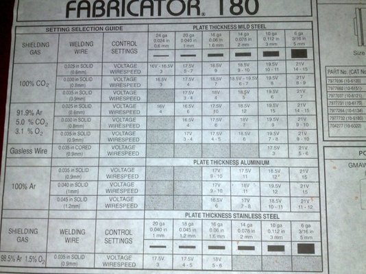

.....If your making ornamental gear you may get away with welding thicker steel if it has to be full strength or structural then buy a higher amp mig ,if your welding lots of thicker metal then go even higher amps so you get a much better duty cycle
