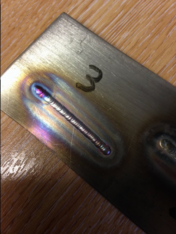

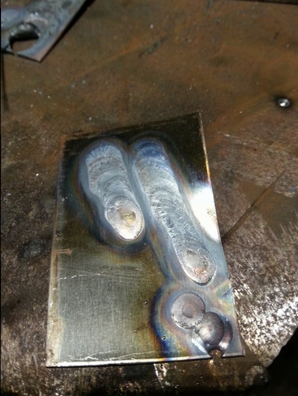

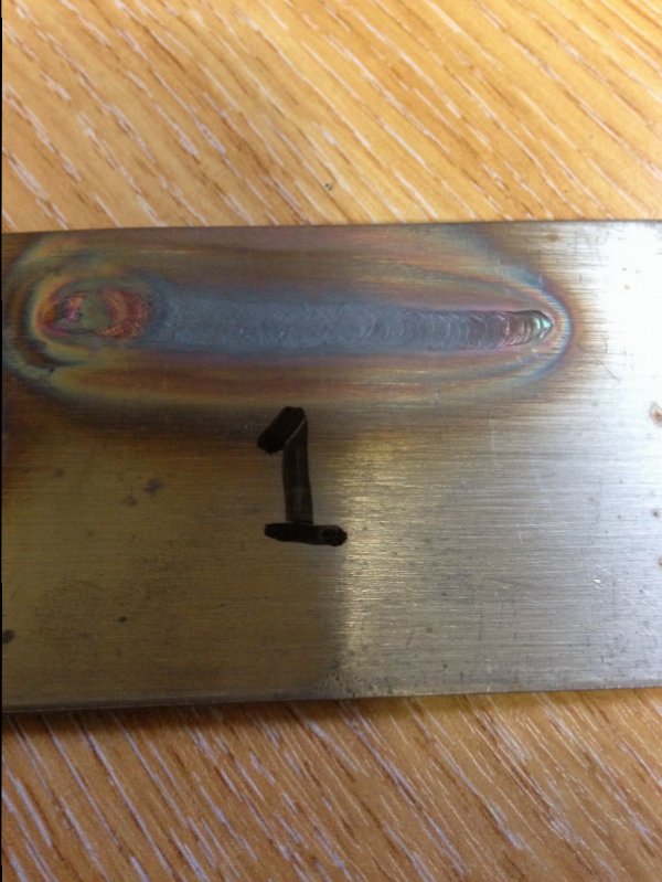

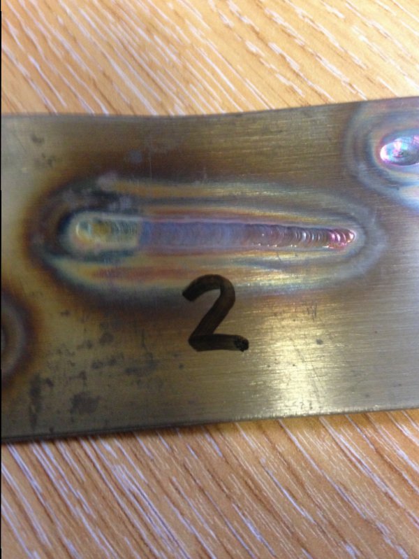

Some mig sets connect the torch to the +ve side for dc welding, dc+ve arcs can be less stable, they also often cause the tungsten to make a massive ball and wibble about like crazy.
Have you noticed the tungsten going from pointed to a ball?? Just a thought, otherwise it could well be the sensitivity of the set not going below x amps?!
