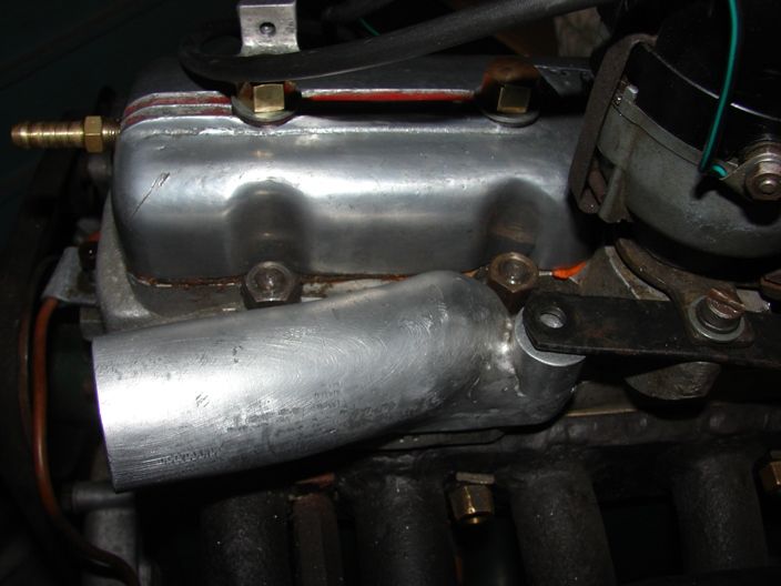

I bought a rare 'Alta' race conversion for the sidevalve Morris engine, circa 1953. Bumps the output from 27hp to about 55hp. There aren't many left and lots of the survivors have some nasty grot in them. This one was quite reasonable but the top water elbow had the usual rot round where the rubber hose goes.
I contacted several casting companies, very few answered and even less wanted the work of making a new one. Harling Foundries, however, said they'd be happy to help. I needed to clean off the grot, filler the area and then get the best smooth finish I could. They think £40-60 for the first one, which I thought was quite sensible. Very pleasant people to do business with.

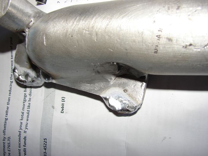

Meanwhile I also made a replica from some ali tube and bar, just in case the original got lost! (8062 ali and 4043 rods. 2.4mm tungsten (white) and 2.4 rods. I think I got it right!)
