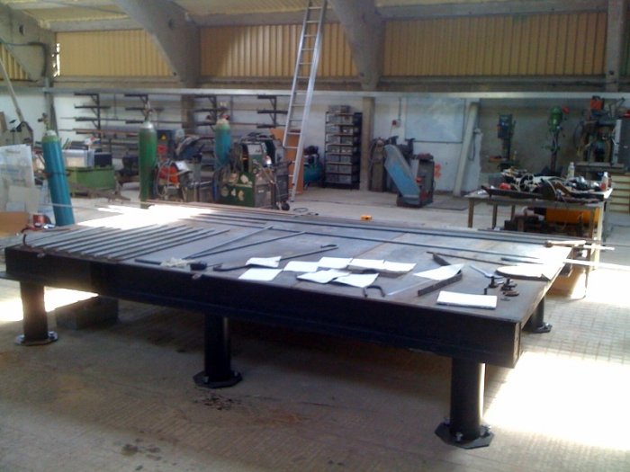

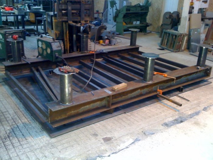

Hi guys. I currently have a 2.5 x 1.25m (8' x 4') table with a 12mm top plate (made from 2 x 6mm plates). Its not big enough, so I'm making another one.

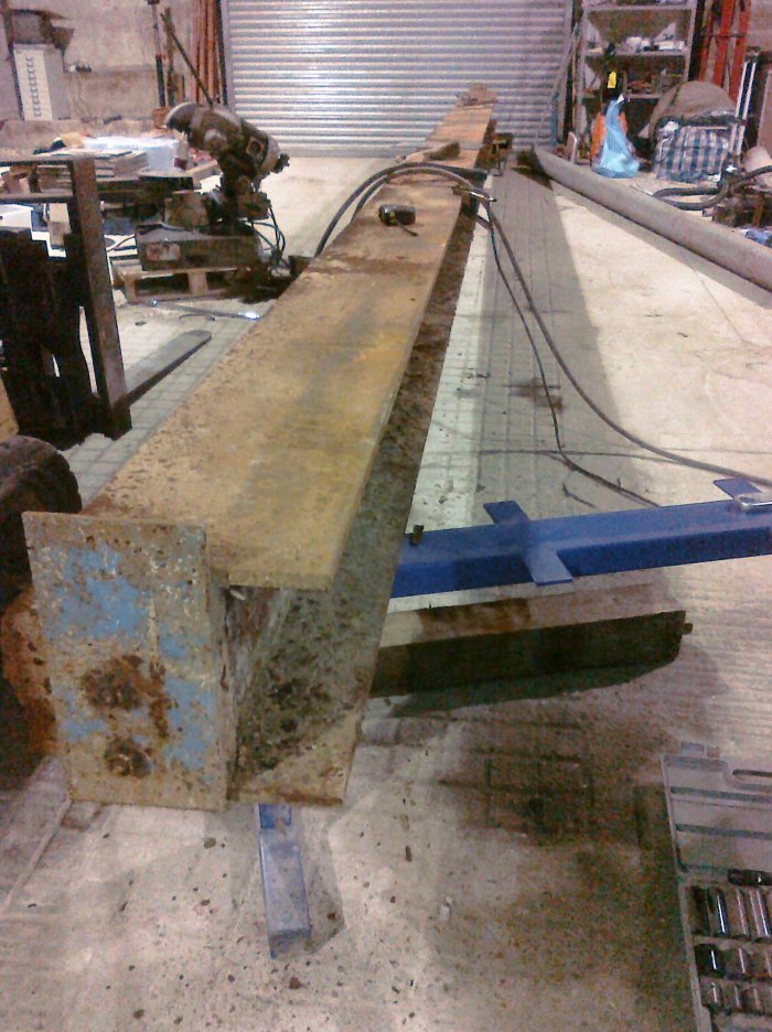

I've decided on 3 times the size, so 2.5 x 3.75m. The top will be 3 plates of 2.5 x 1.25m laid side by side. I have some 10" I beam to use for the main frame.
A few questions:
1. Should I leave an inch between the plates for running t-slot nuts / clamps into? I figure I could always have a strip which I throw into the gap if I need a solid surface.

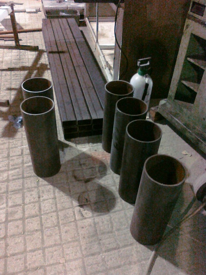

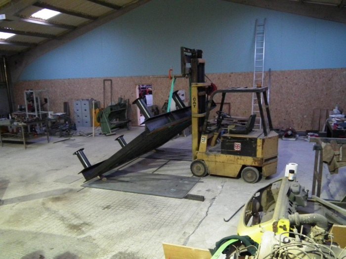

2. I figure it'll weigh just over 2 tonnes when its done. What shall I use for feet? I'll need to be able to adjust the height of each (6 off).
3. How shall I attach the top plates to the I-beam structure - just weld it and hope it doesn't warp? (I actually have to pay real money for the top plates, so I'd rather not screw them up on day 1).
4. What useful features have you seen / done / shall I include?
5. Shall I bolt it down, or have it free standing?
Ta, Al.
