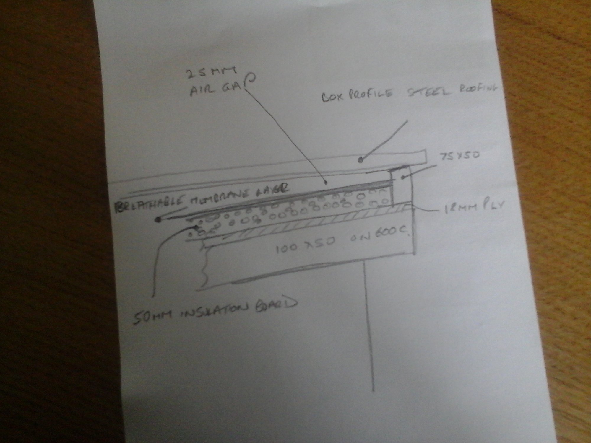

rosinante Member Messages 1,346 Location Cornwall England May 8, 2018 #1 Hi all , as per the pic ,will this idea work , there is a planned air gap of 25 mm under the low part of the steel roof. The corrugations will also allow air flow, Have I got this right ? Thanks Chris 1525774758652-1891355885.jpg 246.1 KB · Views: 78

mfletch Member Messages 431 Location Mansfield May 8, 2018 #2 Is the 18mm ply treated as it will still get rain blowing thorough
rosinante Member Messages 1,346 Location Cornwall England May 8, 2018 #3 Good point , hadn't thought of that, the overhang can be increased to a minimum of 150 mm and I could fit a fascia, that should be ok I think, C

gaz1 Member Messages 20,722 Location westyorkshire May 8, 2018 #4 you dont need to do what your doing you can lower it so its more sat on the beams instead gives better fall and also the insulation boards can go between the joists http://www.mig-welding.co.uk/forum/threads/shed-roof-change.57025/#post-702059

Burdekin Chief Bodger Messages 6,659 Location Aberdeen May 8, 2018 #5 Pics showing roof setups. http://www.mig-welding.co.uk/forum/threads/new-shed-roof.81205/page-2#post-1153601
