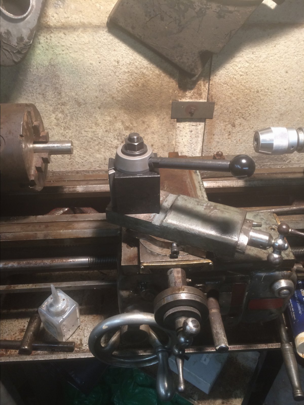

recieved and fitted the wedge type 200 size tool post from arc Euro today. Had to modify the top slide and centre pin for the tool post slightly as I didn't have a tap to match the one thats cut on the pin when it arrives, so ended up tapping the hole to m16 and using a die on the pin.
Anyways it seems well made for the price, haven't had time to try it in anger yet but it's on and done
