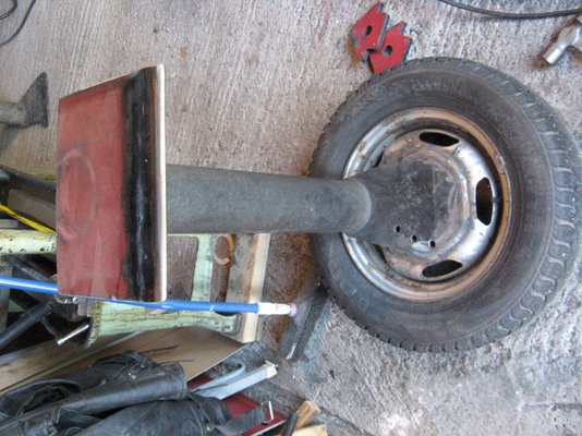

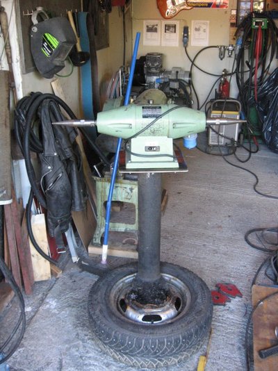

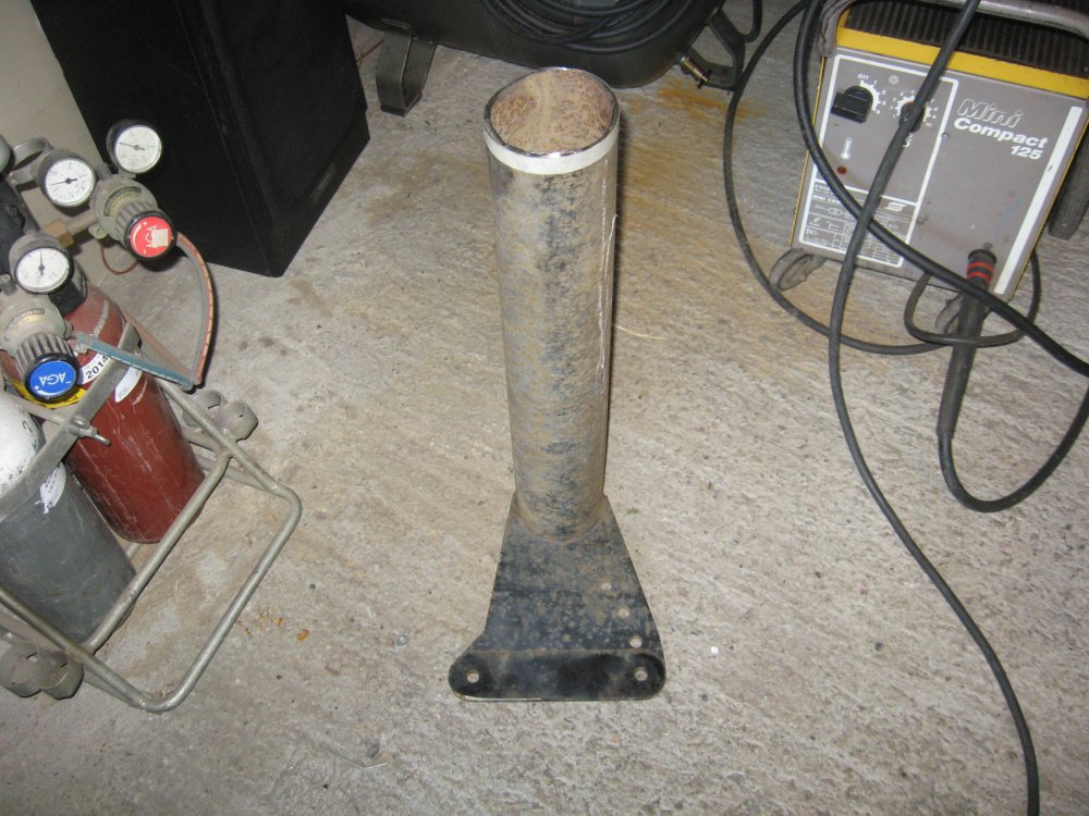

Stand on the tyrehow do you get your feet upto the machine with that idea
Hey!!!!!! He tried bless him. Sometimes you need specifics.When someone said "put in on wheels to make it easy to wheel around the workshop", I dont think that was what they had in mind![]()
Hey!!!!!! He tried bless him. Sometimes you need specifics.![]()
Given the muck that pollishing makes I would be taking it outside to use.I reckon the tyre will be a bonus - broader base for stability + easier to roll around the workshop if needed.![]()
Even when standing on it ?it should realy be bolted to the floor. the pressure needed for polishing will push it over![]()
a bit of light polishing maybee but when pushing with a decent size wheel and u slow a 2hp motor down noGiven the muck that pollishing makes I would be taking it outside to use.
