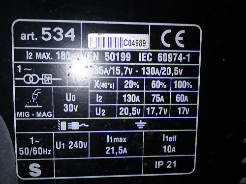

M monkey01 Member Messages 23 Feb 17, 2011 #1 Hi would just hoping for some help looking at this and wolud like to know if this is any good for bodywork amps etc regards. spec.jpg 49.3 KB · Views: 277
shenion Tool Pack Rat Messages 7,582 Location Stone Mountain, GA USA Feb 17, 2011 #2 Says 35A minimum. A bit high, but usable with 0.6mm wire. Says 15.7V, that should be fairly low on 0.6mm.
