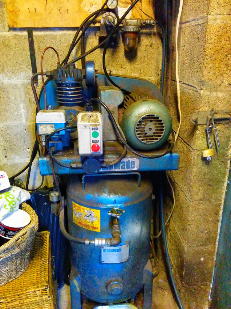

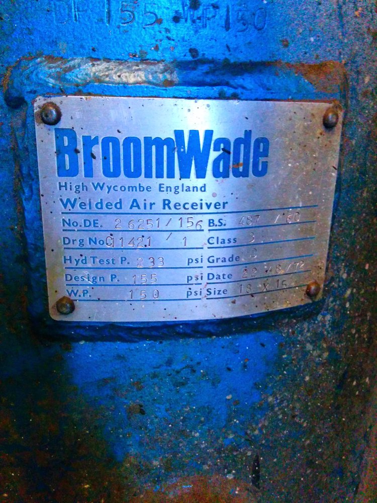

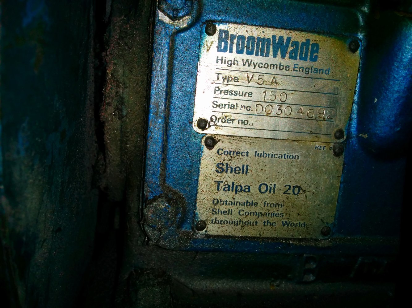

Hi all, new member here. I acquired a Broomwade compressor as part of my house purchase a few years ago. I've used it a handful of times and would now like to give it a bit of a going over and use it more often. The emergency stop switch doesn't work (as soon as you stop pressing it the motor fires back up!) And I'm not sure the pressure switch works (I've always switched the motor off when I get to about 90 psi) It needs the receiver tank cleaning out, a new inlet air filter, and the filter/regualtor/water separator and hoses all look due for a replacement.
Pictures to follow and any help/advice for a complete novice would be welcomed!

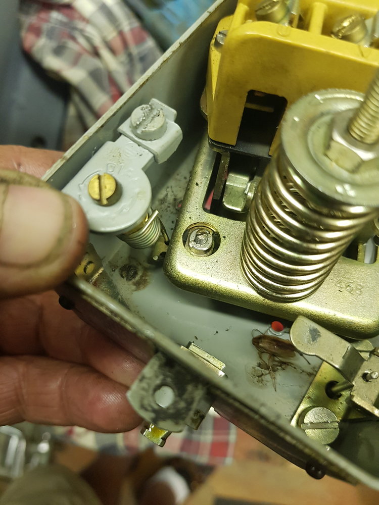

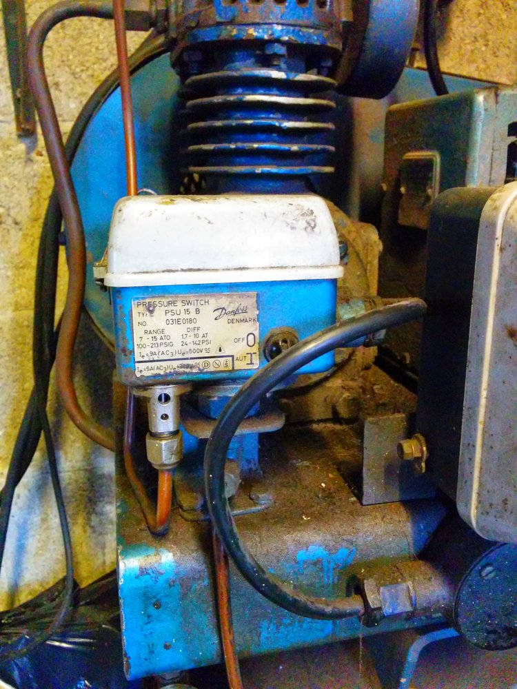

We'll sort of. It trips off at 90psi and back on at 40. (I'd never dared let it go a over 80 as I've not yet inspected the inside of the receiver) but i let it run last night and its all good. So I think I just need to wind that middle nut in a bit more to increase the pressure at which it auto cuts off?
