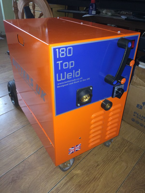

OrangeMy New Mig just been delivered ....off for a play, thank you Fosters at Shepshed, great service
Phewww, no comments of the spinning wheel behind it that Liz's toy , regarding the hair loss, too late
Considering its current home is in middle of lounge, it's colour does work as a trip hazard warningI wouldnt like to bump into that!

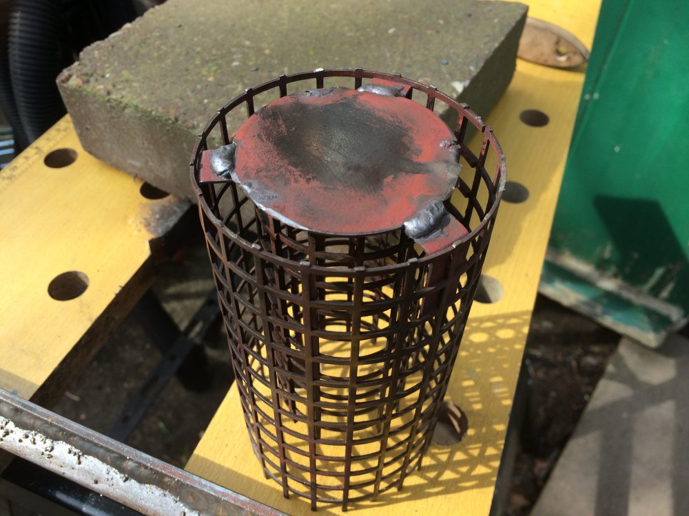

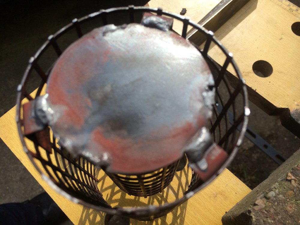

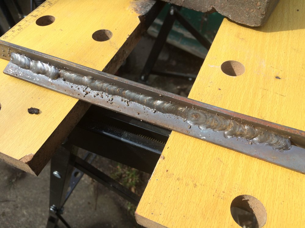

Here is my first attempts with the Butters, the fillet weld was done on various setting around 3 and 4 with varying wire speeds, the middle of it i thinks the best but possibly still a little fast on wire speed, the wire mesh catayst (for a oil stove on a boat) is stainless and just wanted tacking back together this is about the thinnest id weld normally and i use normal wire mild steel wire that came with the machine, that was done on setting 1 with .8 wire with the speed at about 10 o clock
