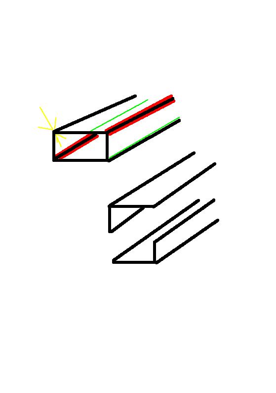

What I want to do is build some tubing to slide in 2X3 rectangular tubing with a 3/16 wall. The inside dimensions are 2-5/8 and 1-5/8. It seems to me that I want to cut my 3/16 sheet to 2-1/4 and 1-1/4, and the corner welds will essentially be the radius that fills the corners and fits into the 2X3 tubing.
Does that make sense? Certainly I will play around with this before making the final product, but I would very much appreciate any suggestions.
