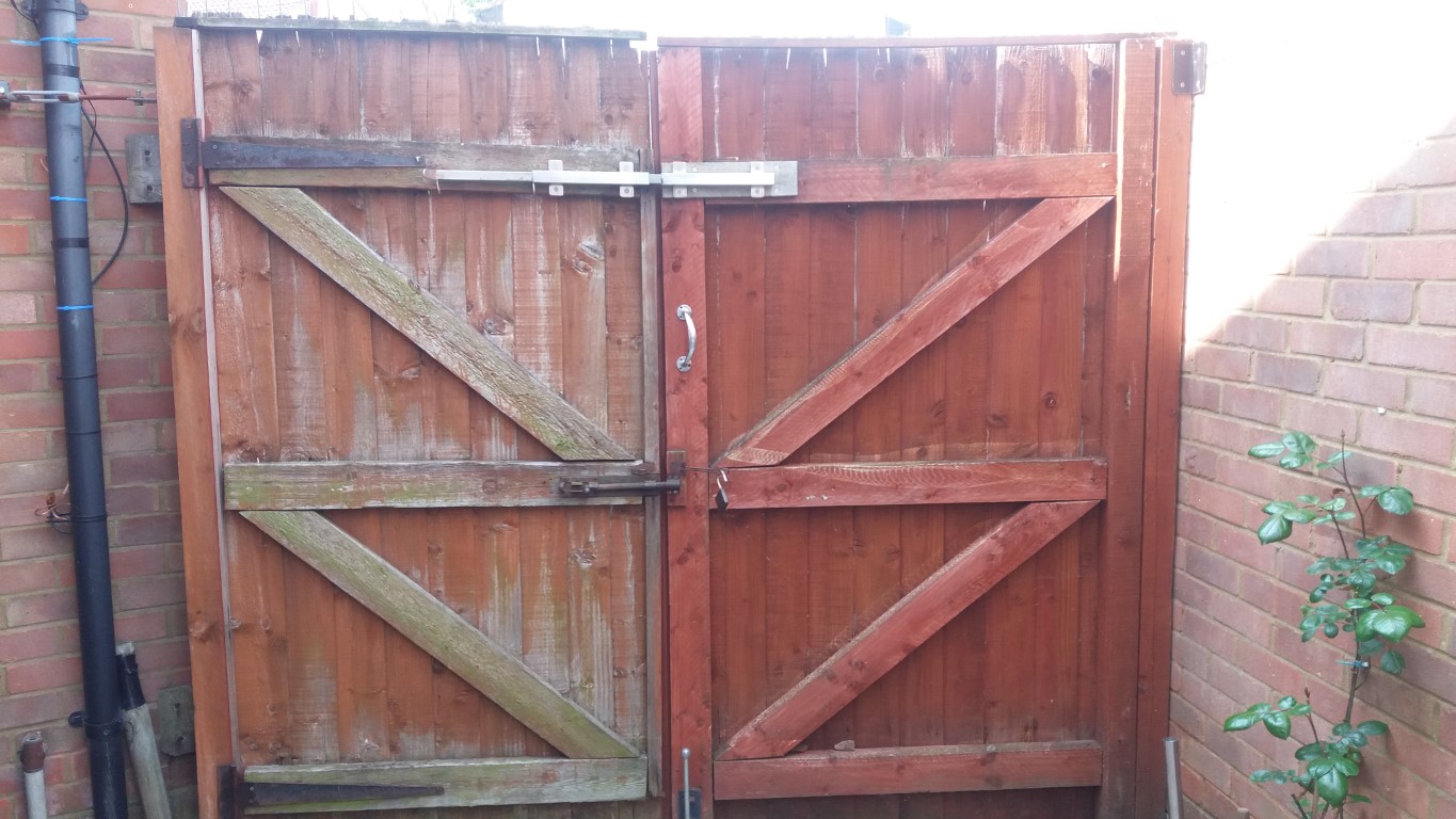

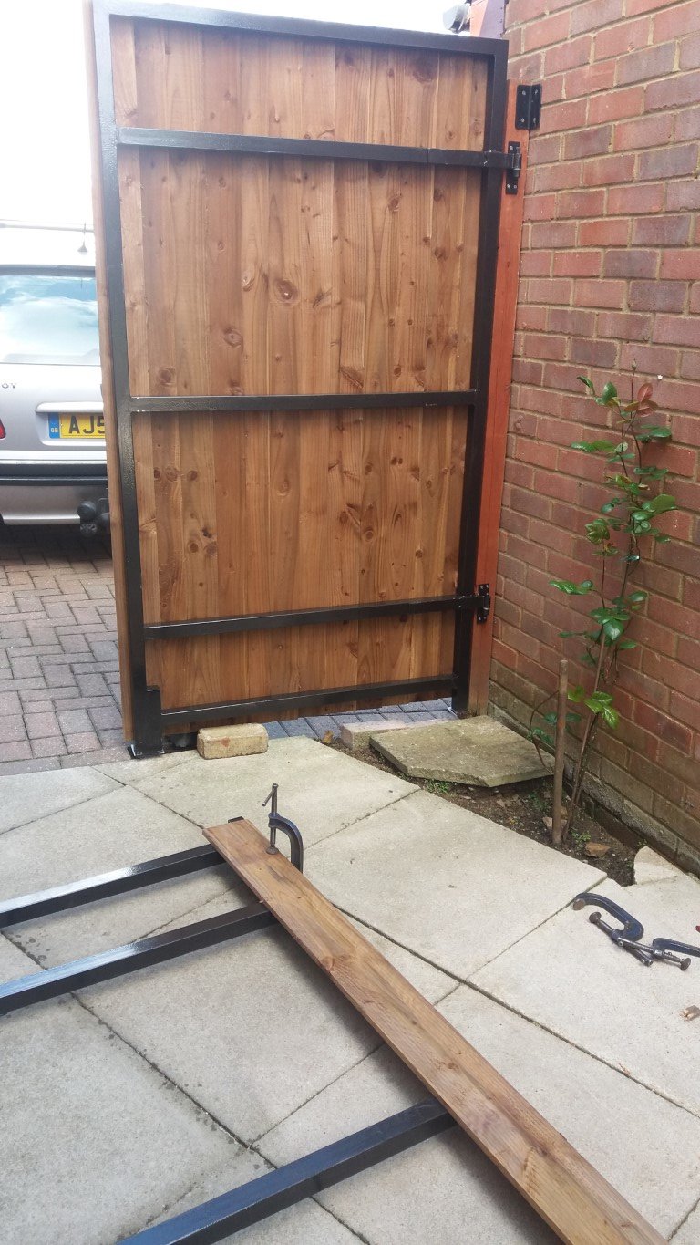

Little gate job I've been doing for myself, this was originally a fence with one gate, about 20 years ago I converted the fence and made it into a pair of gates to get my trailer through.
they have been repaired a few times over the years and are now well past their sell by date, and to make it worse domestic management has been making an annoying whining noise about it, so something had to be done.

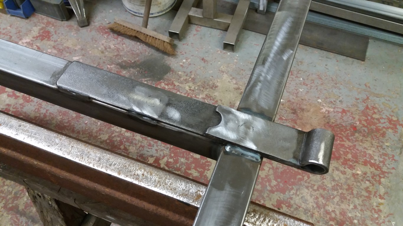

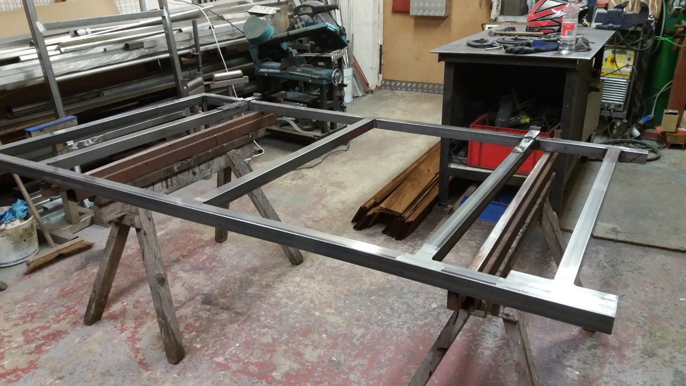

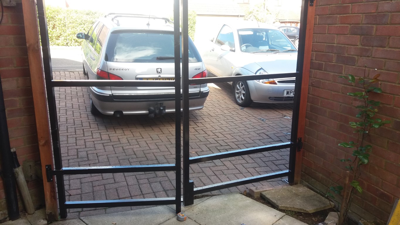

so a few lengths of 40 x 40 erw left over from a job were made into a couple of gate frames
And fitted with modified farm gate hinges, and then hammerited.

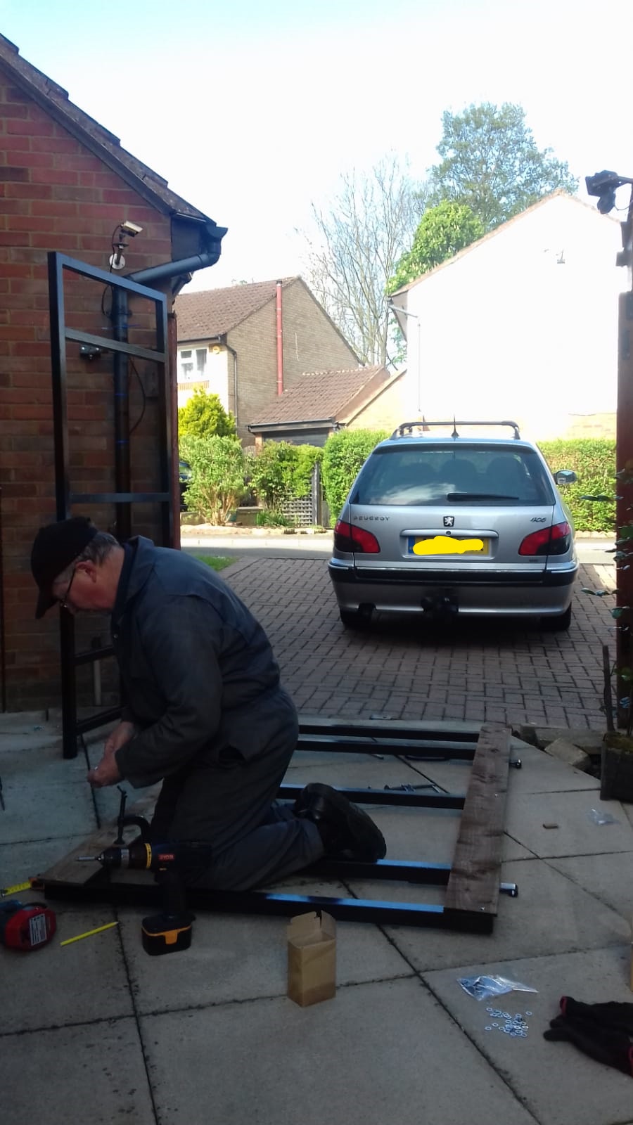

Then first get the frames fitted and swinging properly,
Then clad them with feather edge boards, some bloke here powering in tek screws.

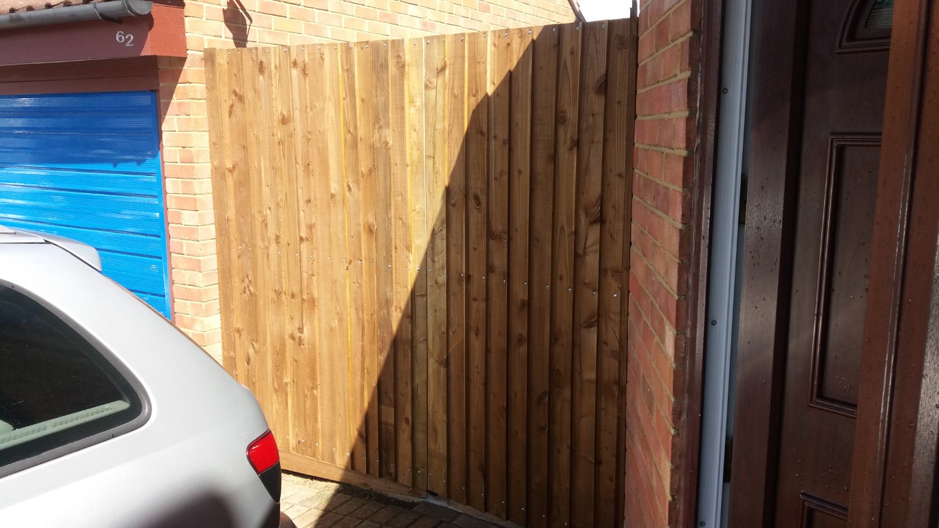

A couple of brenton bolts and we're finished,
From the outside looks like a fence rather than gates
