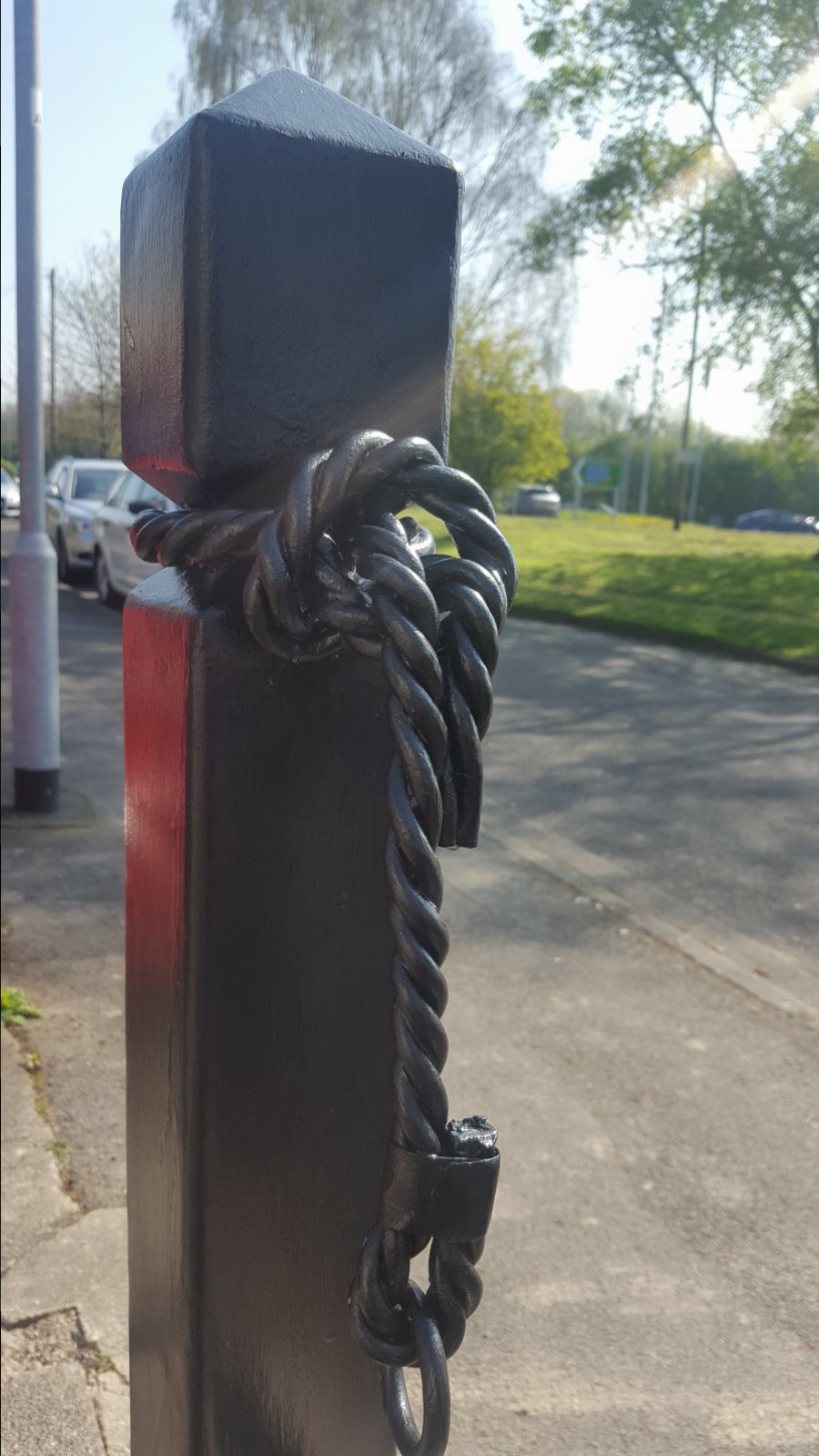

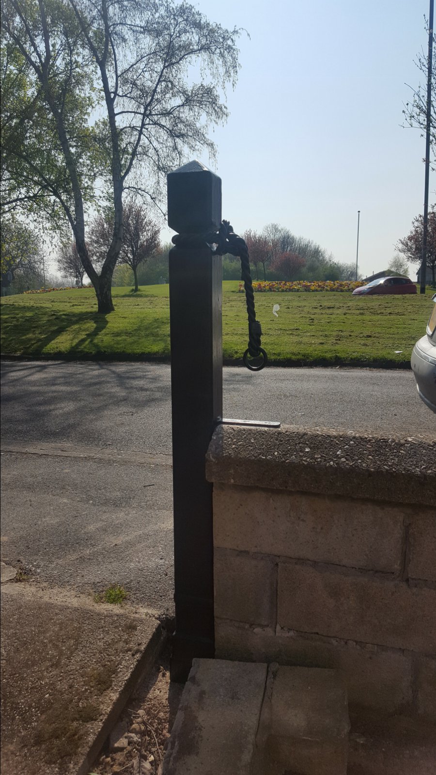

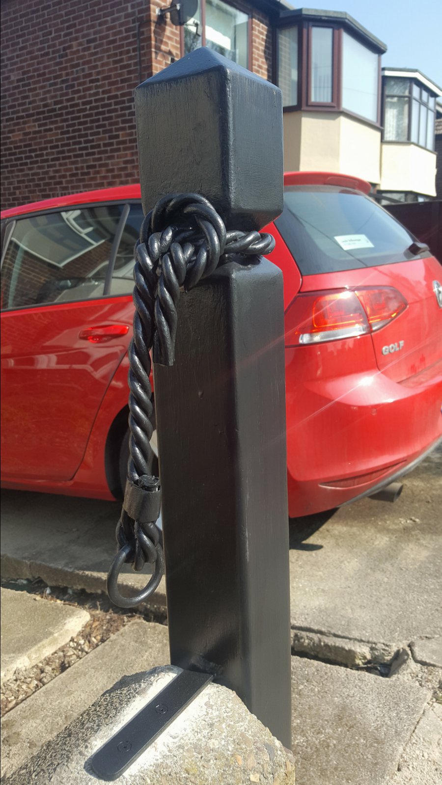

Gate post made from 100x100mm box with a rope made from 3 lengths of 8mm round bar twisted and tied in a slip knot. I wanted a knot at the other end but it was too hard to manipulate once it was round the post so I settled for the loop. I've got 3 more posts in the workshop (somewhere) for the top of the wall that will be looped together and to the rope with chain.
