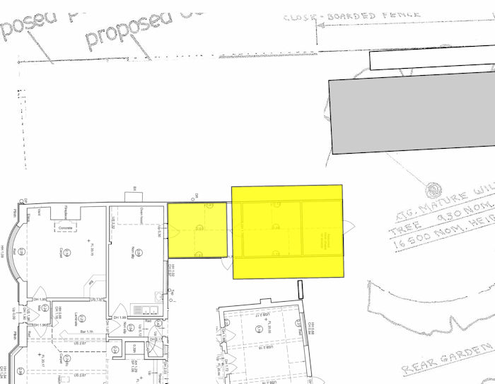

I'm after ideas for a new garage to replace an existing shed. In the drawing below you'll see two yellow boxes - a ultility room to the left and a 6x5 garage to the right with the outline of the existing shed shown with grey lines.
I want to avoid planning and building regs so the garage is the size that can avoid both and there is a gap between the garage and house to satisfy the conditions for no building regs. I really want to avoid planning as while the garage would be exempt from conservation area rules because it behind the house I think it would be a conservation area application because it's in the curtalige.
The gap is going to fill up with leaves and become a mess or a fire hazard. I could just about cope with involving building regs in the project and I have an open channel running around the house so levels and petrol spills shouldn't be a concern. It won't be heated so no part P. It will be made from wood like the current shed in that position.
Any ideas how to get rid of the gap and be legal permitted build with minimal hassle?
