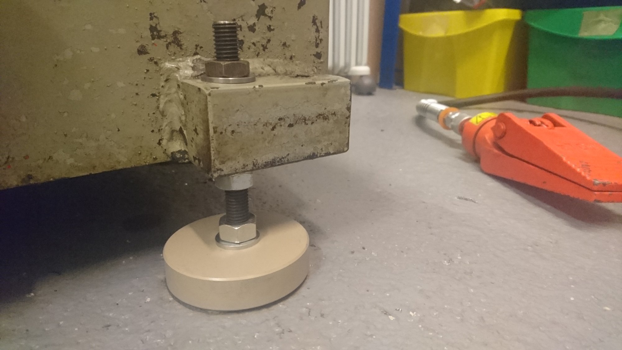

What the title says. Mild steel 75mm round sawn, turned, drilled and tapped. M12 High tensile threaded rod screwed in with nuts/washers. Recess turned in base with 5 mm thick piece of rubber epoxied in.
