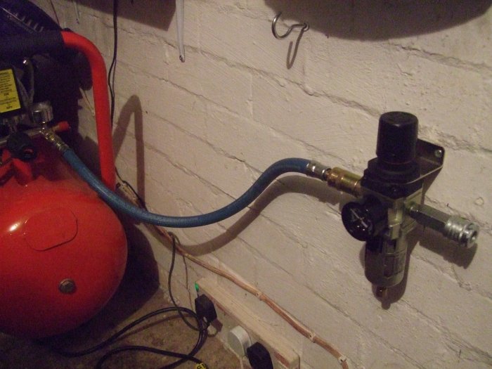

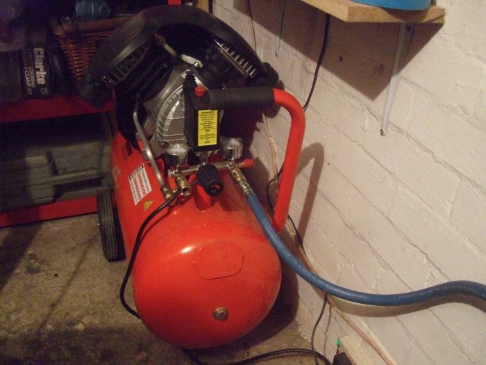

Hi there,
Ive now sorted the garage out and placed the compressor in the area it will be staying for a while. I have fitted the whip pipe and wonder if the set up ive fitted is good enough for occasional spraying, light work etc. I could do with some ideas on how to go about fitting the best system for paint spraying, in my small garage ?
I have 2 small filters and one new medium filter at the gun end, should i fit the compressor side filter/reg lower or higher than where it is now. From what ive read on the compressor tutorial DIY set up page it needs to be higher ?
Could you please link me some places that sell things like, drop leg outlets and copper piping etc ?
I will be fitting the 10mm pipe up high from this filter then back down further down the garage to a hook then it will lead to the floor for use.
Any other quick advice on how to go about getting the best prevention from water/oil when paint spraying would be appreciated.
I have this filter http://www.justoffbase.co.uk/Air-Filter-Regulator-Max-Air-Flow-70cfm-Sealey-SA106FR > would it filter the oil, i ask because i read there also needs to be a special oil filter on the tutorial ?
Also, they only sell the small connector on the whip pipe that goes to the filter instead of the preferred euro type
One more thing, would using large duct piping over the compressors filter and lead them to the rear window be the best idea of solvent prevention, or shall i use a large plastic sheet over the rear of the car from ceiling to floor to block it out ?
A few pics for you to check over >
