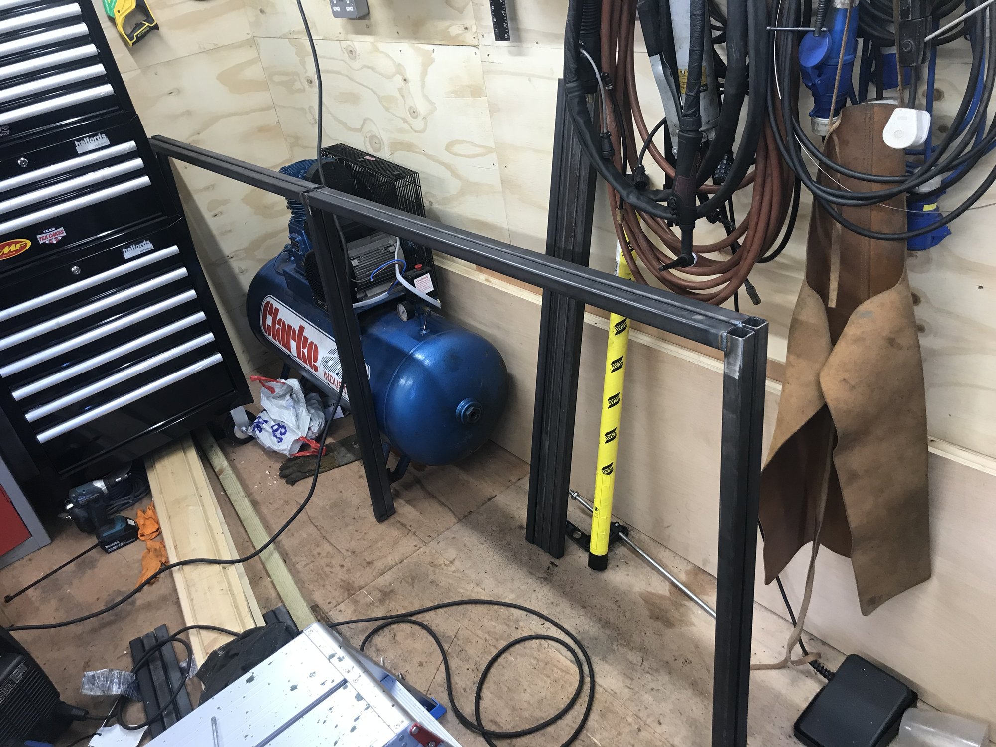

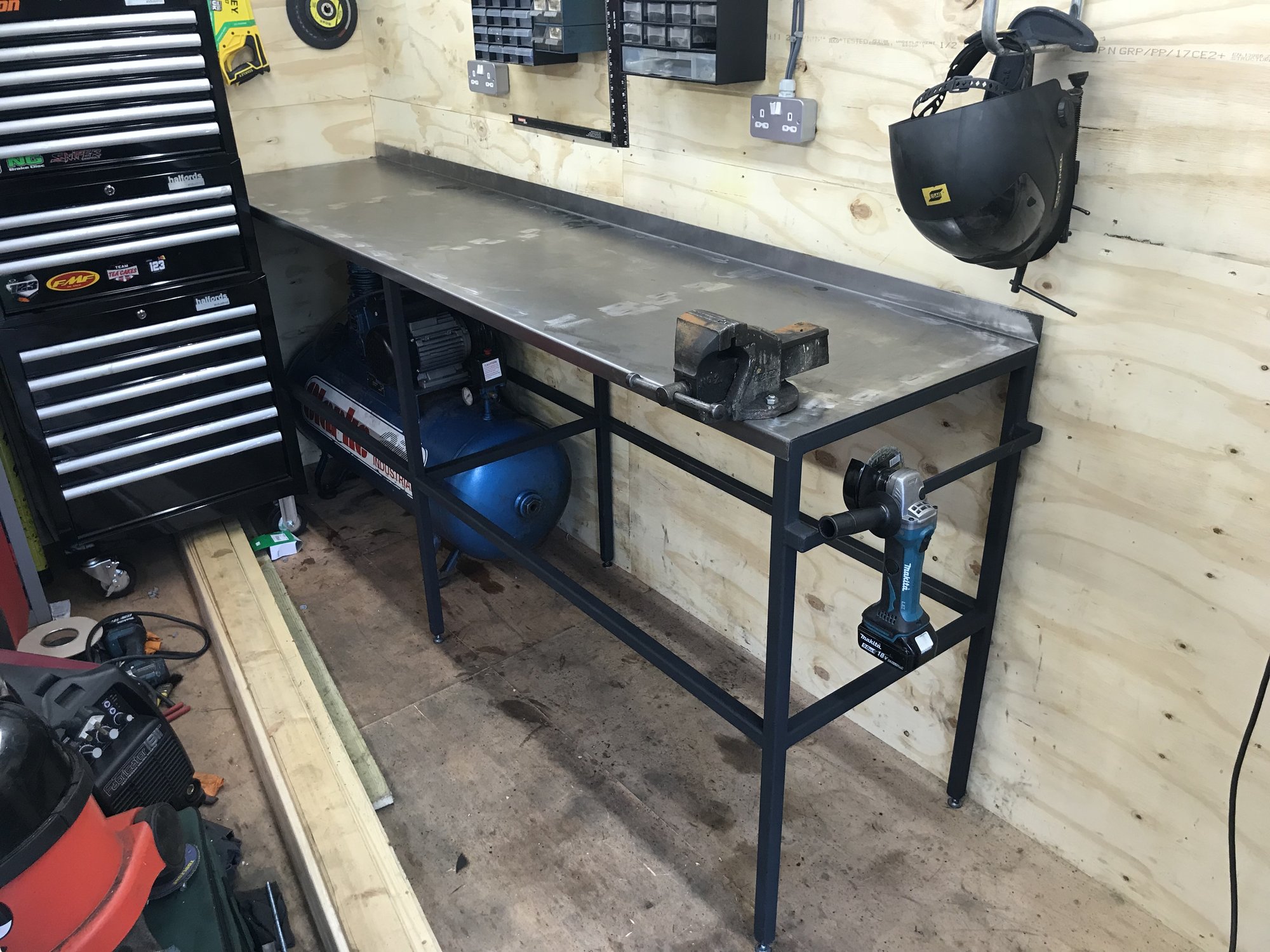

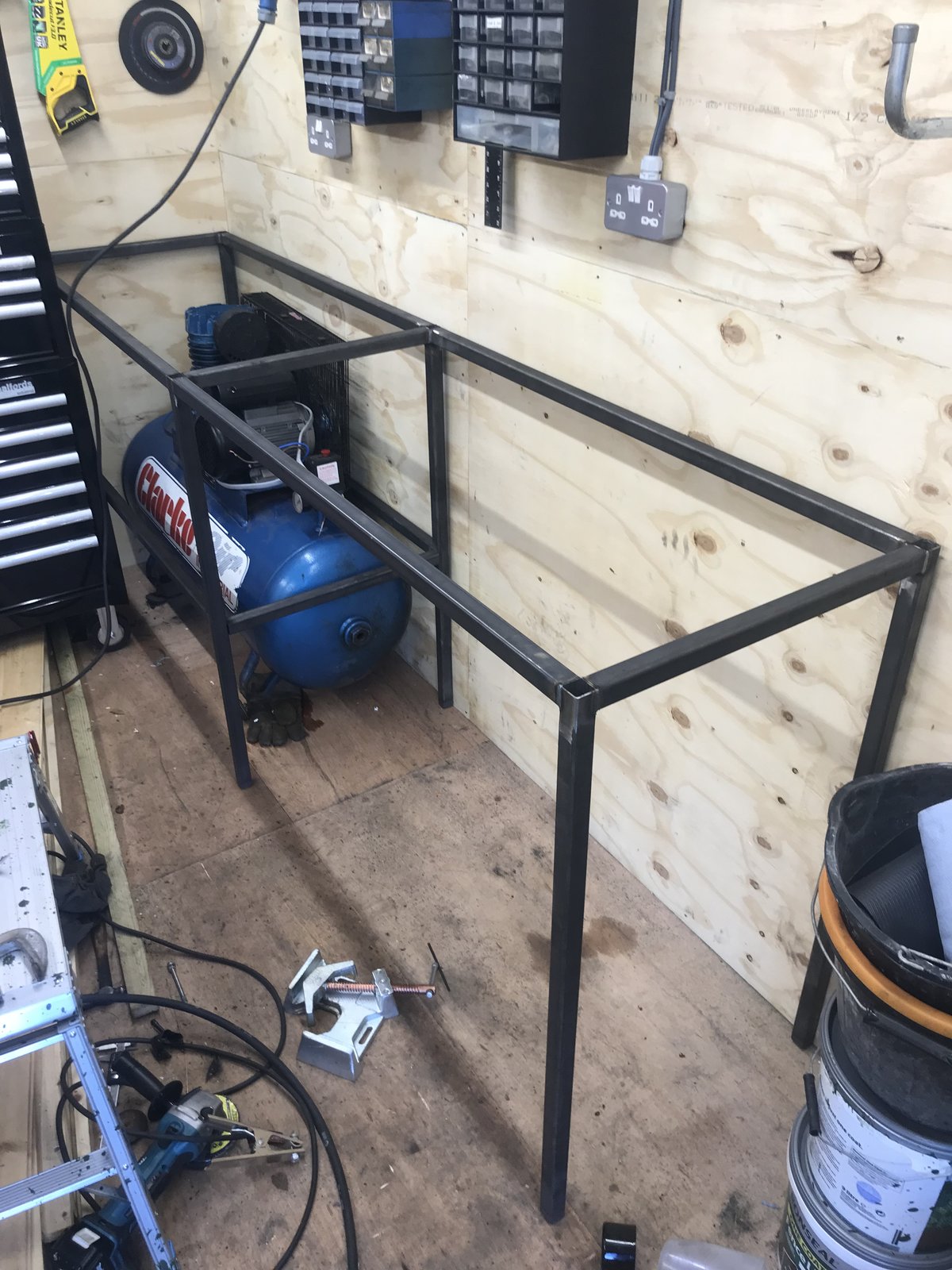

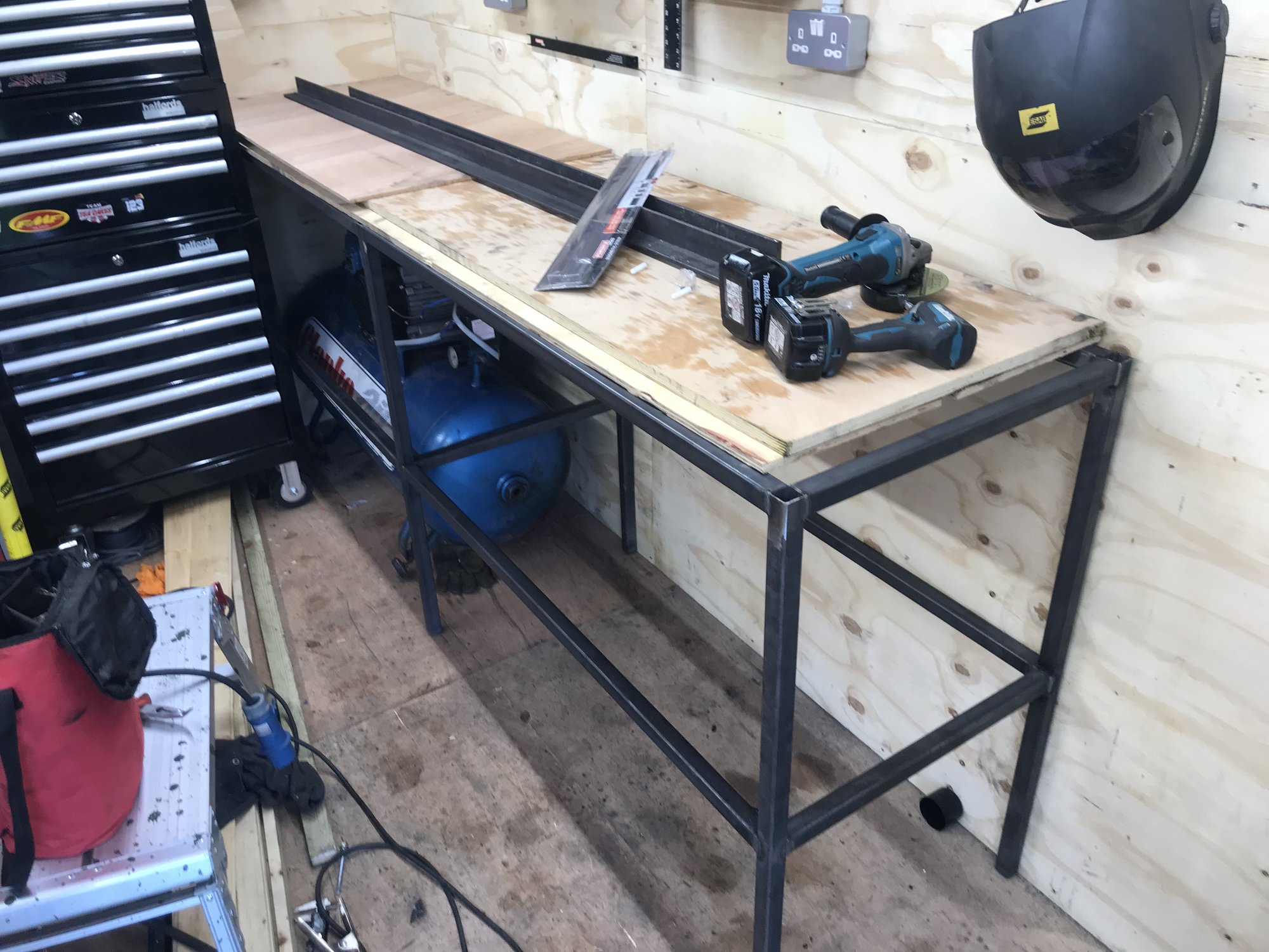

So I have been planning this bench for a little while. I ordered 2.5mm sheet and three lengths of 30mm box.
I didn’t want anything to extreme for the time being, when I do my garage I’ll built something more substantial. For specifically welding.
Anyway, so this was such an awkward job. I should’ve done this before moving everything in. I had no room and trying to make something so big square in such a small space was super hard.

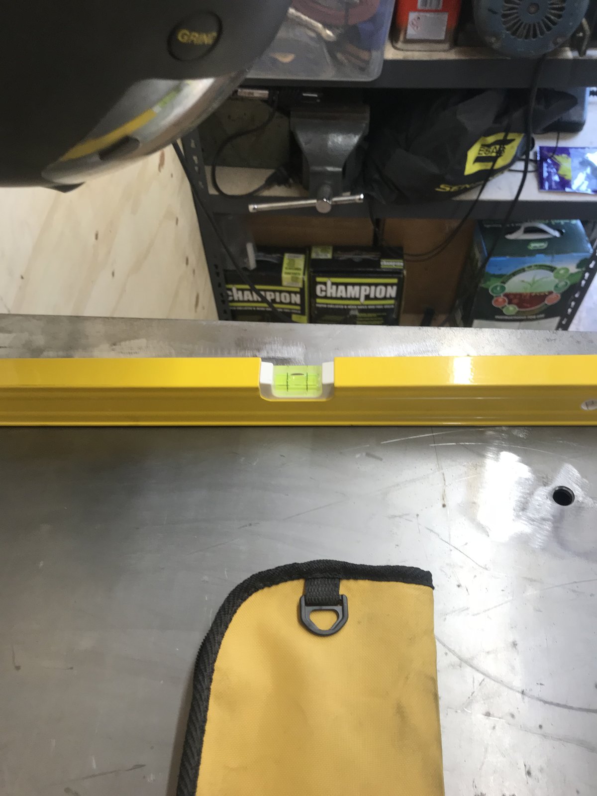

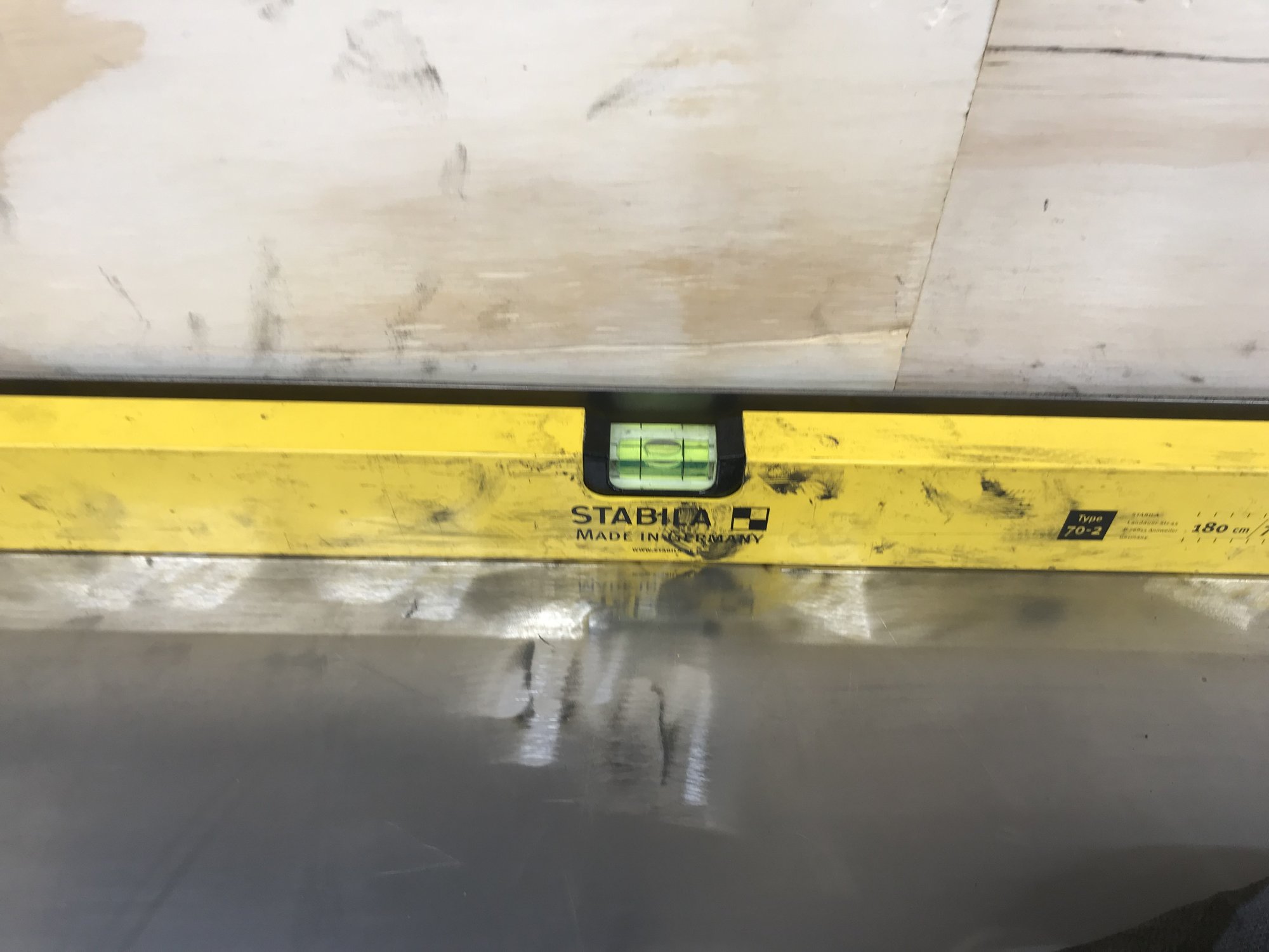

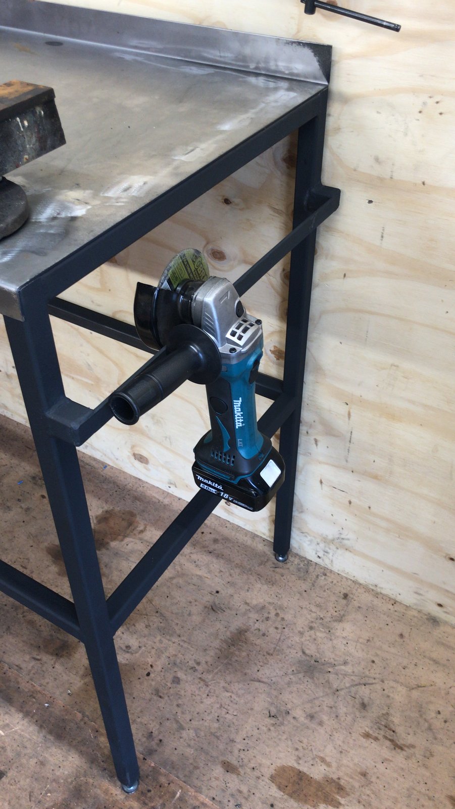

As you can all see, I made it so I could level it and take it anywhere I’d like. I made a shelf underneath on the right and will be enclosing the compressor when I get some more wood.

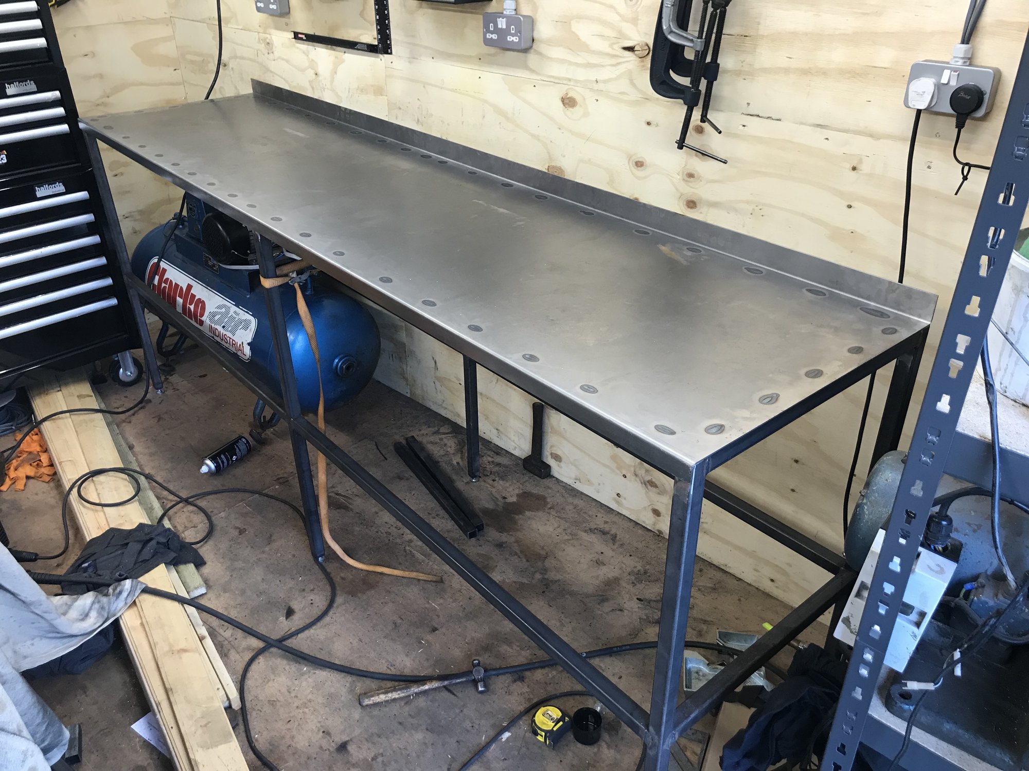

I had the top sheered and folded for £30 at my local fabricators which was a nice touch for the final result. I also gave it a quick once over with some stone chip paint on the whole underside.
I’m going to buy a scotch pad disk and clean the top. Any idea what I can use to stop the top rusting?
Thanks
