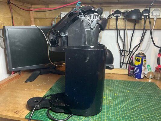

I don’t suppose anyone here’s got experience with these?
Red ring of death. Stripped down and cleaned, which wasn’t as bad a job as I thought.
However, it's now leaking at the front. The coffee is coming down the inside surface of the boiler, onto a plastic tray and down the 'waterfall' at the front. I can see this happening with the side covers removed. Everything has been cleaned and checked, and I've stripped and reassembled multiple times. There's no play in the lower rotor bearing.
I don’t think it’s a seal misplaced/leaking, as the coffee flows into a semi-open channel before discharging through the spout, and it’s this channel that seems to be overflowing.
