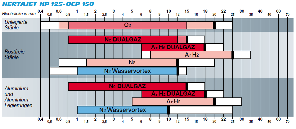

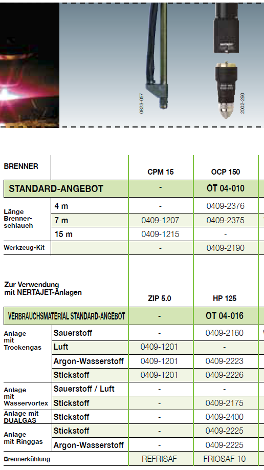

I have got a used nertajet hp125 plasma that is missing torch ocp150.
I see in the manual that this machine does not cut with plain air but only with industrial gasses.
Can i use a plain chinese torch that cuts with air instead of ocp150 ?
Where can i buy a reasonably priced ocp150 torch?
Because the ocp150 has more cost than a whole chinese plasma machine
makes sense just to get ocp150 torch or get a new chinese machine ?
I mean the cuts with industrial gasses that needs nertajet hp125 are significantly better than
chinese plasma with plain air ?
