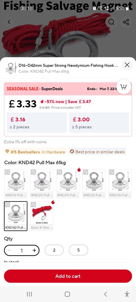

Does anyone have experience of using these magnets on corten steel shipping containers? I'm guessing the advertised pull force is exaggerated or difficult to achieve. I want to screw the magnets to lengths of slotted channel (unistrut) to which I'll be fixing 400W panels.
The container is in a relatively sheltered location. I realise there are uplift calculations for panels but I'd like to start with some rough ball-park figures to check if it's viable. I've watched a YouTube video in which some guy in a desert uses magnets on his container.
