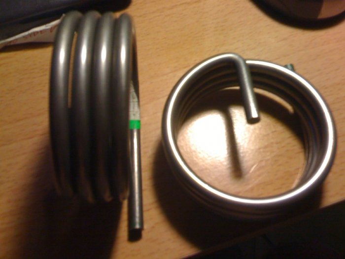

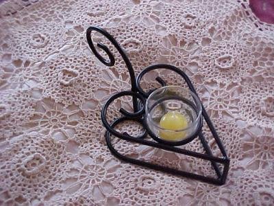

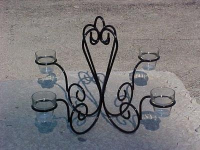

Can't buy them cheap so i had to come up with a way to make them. So i took my powered scroller and removed the scroll die and added a modified round die from my HF/Clark bender. Instant rings. I can do 30 or more a minute instead of 4 in a half an hour in my ring roller and they are all perfect. I wind them up like a big spring around the die then snip the apart in the bandsaw. I can make 8 at a time. So if anyone needs lots of rings give me a yell. I can do from tiny to 5" +. This is what i do with them, make candle holders for the ladies...Bob
