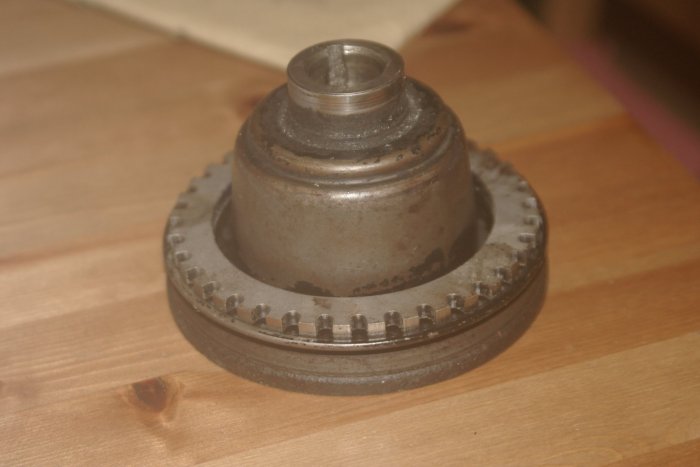

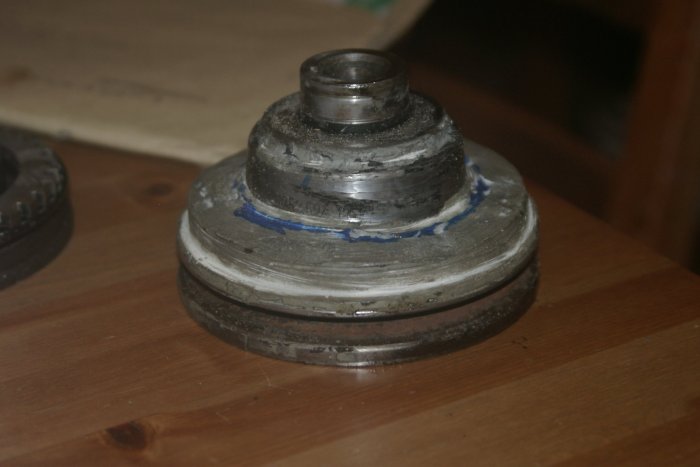

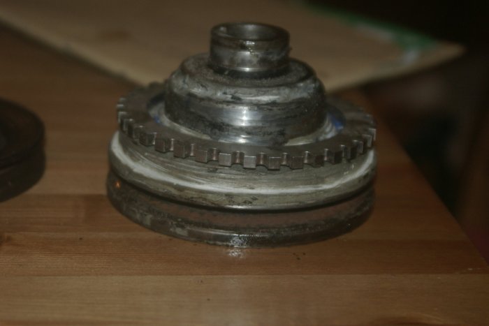

I need to fit a trigger wheel to the crankshaft pulley of my track car so I can get the EFI working. The usual method seems to be to build up the pulley with JB weld type stuff, then machine it down to the right size for the trigger wheel. Once you determine the correct position for the trigger, you butter the wheel with JB then stick the wheel in place. I can get JB weld type stuff, but will have to improvise a lathe type tool thing with my pillar drill. I CAN do this, but it may not be perfect.
It'd be a lot better to do it the right way, so anyone around Manchester with a lathe that could do the job in return for some beer vouchers??

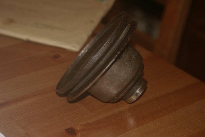

should have read the post properly do you stick it on the front or the back of the pulley?
