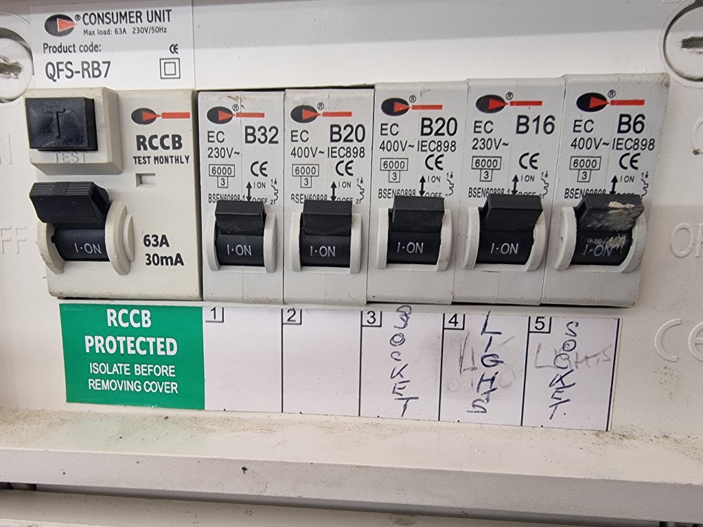

I have this consumer unit with 2 slots labelled as 'spare' which I need to use but with lower rating so want to find a couple of MCB's to go in it. Here's the unit, appears to be lewden palazolli by searching the product code.
And I've found these MCB's for sale. Question is, will they fit the above CU?
www.tradesparky.com
Lewden G06-1B16 MCB SP B Curve 6kA 16A
