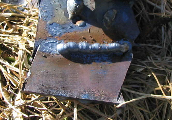

Anyways. I have been stick welding quite happily for a year or so for a little fabrication business I have on the side.
Recently I thought I'd invest some of the profits and upgrade my welder to a mig. So a couple of weeks ago I bought a new (but cheap) chinese imported, mig welder rated at 145amps.
I bought some wire with flux core and straight away I was welding happily away. Now with this wire there is a fair bit of splatter and it is hard to see what you are doing. So I got some argoshield from BOC, as I weld mild steel. bought some cheep mig wire no flux, got me a regulator and hooked it all up.
Gas comes out of the gun, all cool, bu the welding is worse than with the flux wire. What gives? I have played with the polarity and the gas pressure settings, speed and amps and I can actually weld better when I turn the gas off! (though it is still not that good, btw how is it possible to weld without gas? Ithought it would just fuse and stick). Something is not right. The weld basically seems to stutter and sit up high on the practice plates I am using, where as with the flux core I was getting nice low beads etc.
I can only think it may be the wire, as it was cheep, about the equivalent of GBP8 for a 5kg roll. But I thought that wire was pretty much wire. I am normally pretty handy and tend to see probs as the come up but this one has me stumped. I actually did an evening welding course at my local college a few years back and I remember clearly that welding with gas was a lot better than this.
Any advice would be appreciated. Cheers. Swannie.

Whereas a small spare spool of wire of the same size feeds no worries.
I even filed the point of the wire to make it easier to feed in, kept the feed to the trigger as straight as poss etc etc. The wire is just a fraction bigger according to my vernier than the small spool .78 versus .75. Bugger it.
