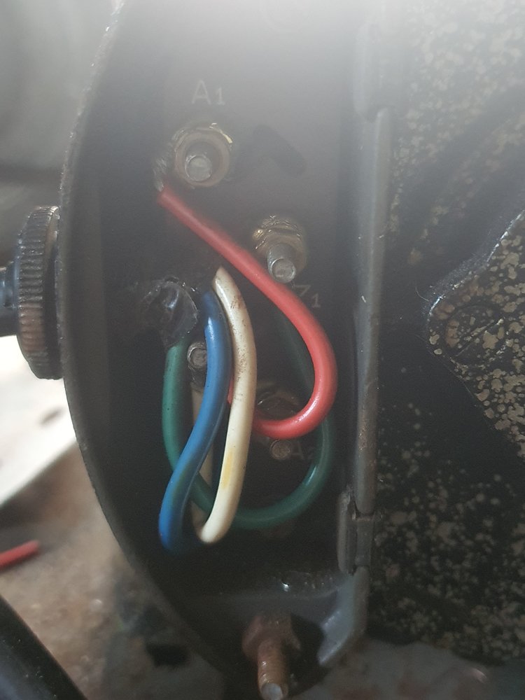

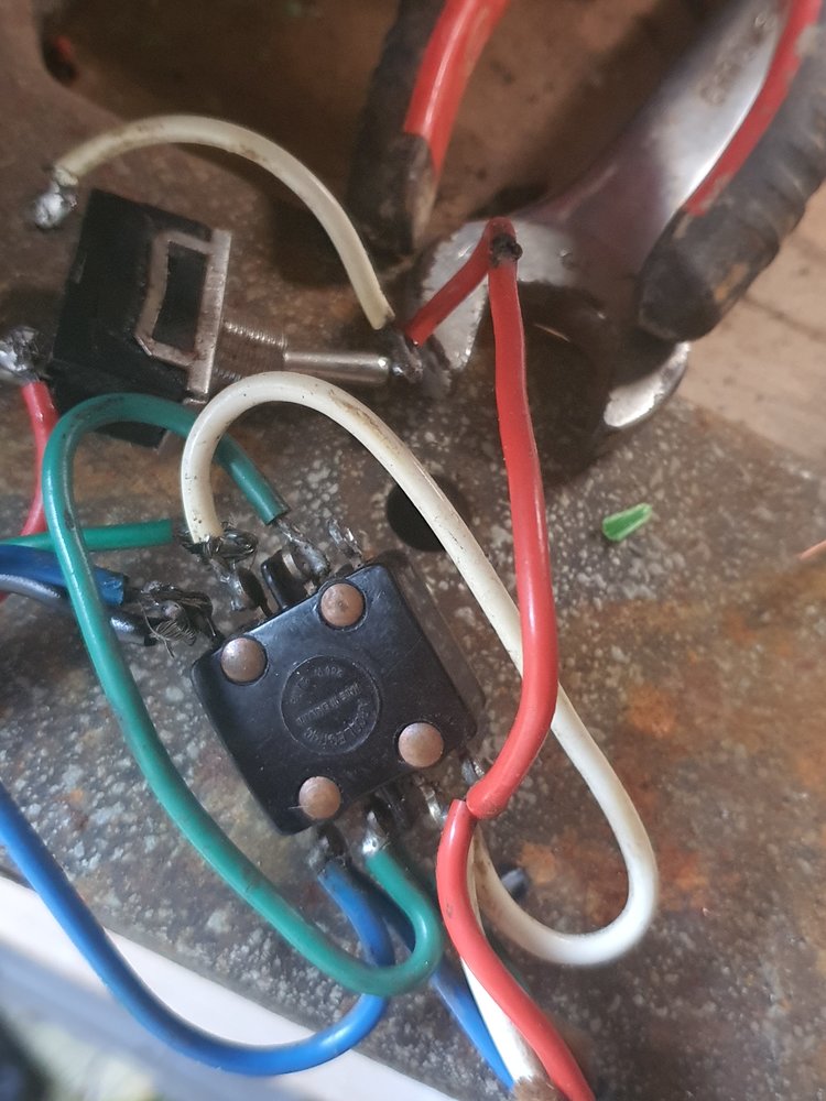

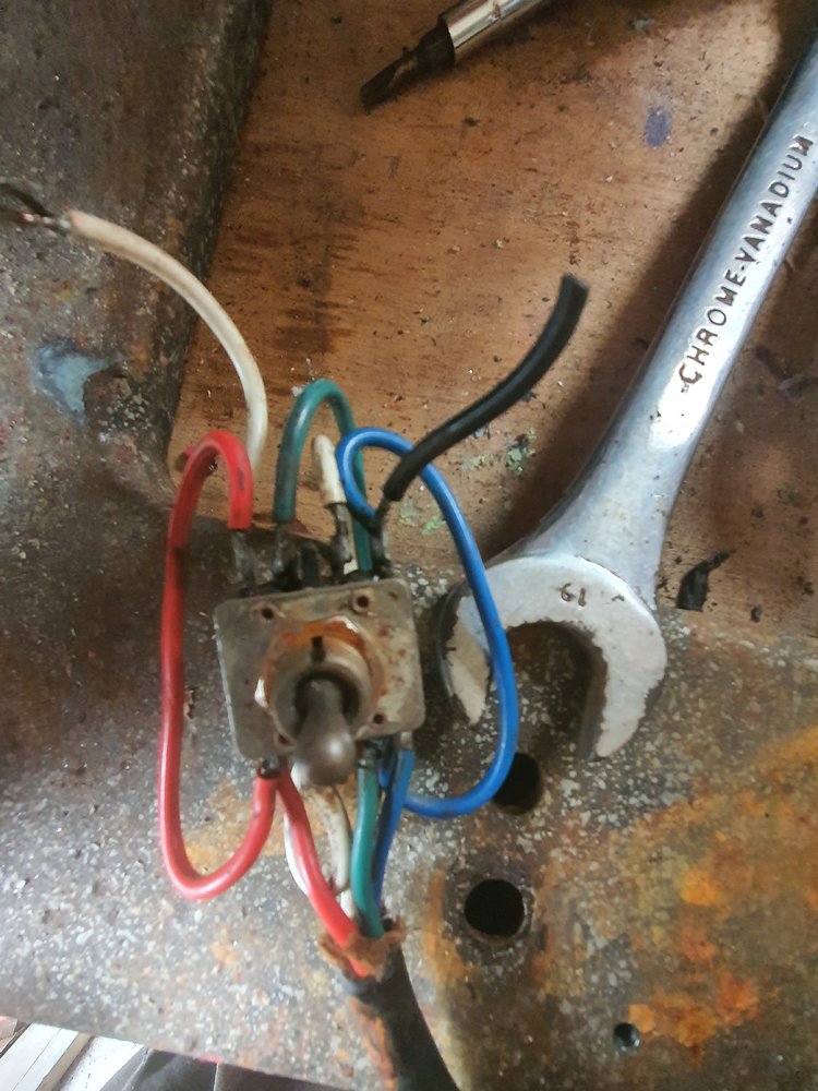

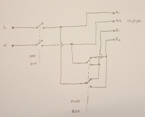

Hi guys i have an old Harrison cadet lathe
It has 2 toggle switches an on/off and a fwd/reverse
The fwd/reverse switch is an 8pin jobby but one of the pins/tabs has pulled loose. My problem is i cant seem to find one anywhere or even what there called searching for 8pin toggle switches takes be to a 12 pin or some else completely.
Any help please
