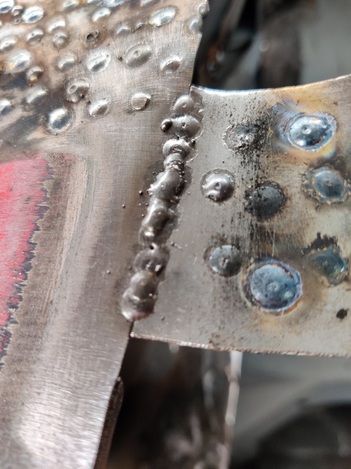

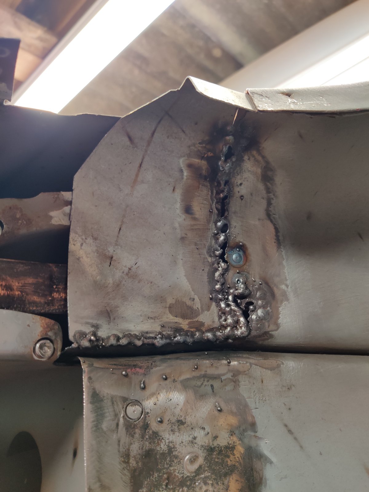

When I have thin metal I start off by have the welder set a little lower than the test piece setting. Then I do a series of 1 or two second tack welds spread along the join.Yes the amps is the wire speed adjustment, and it's 0.8mm sheet yes

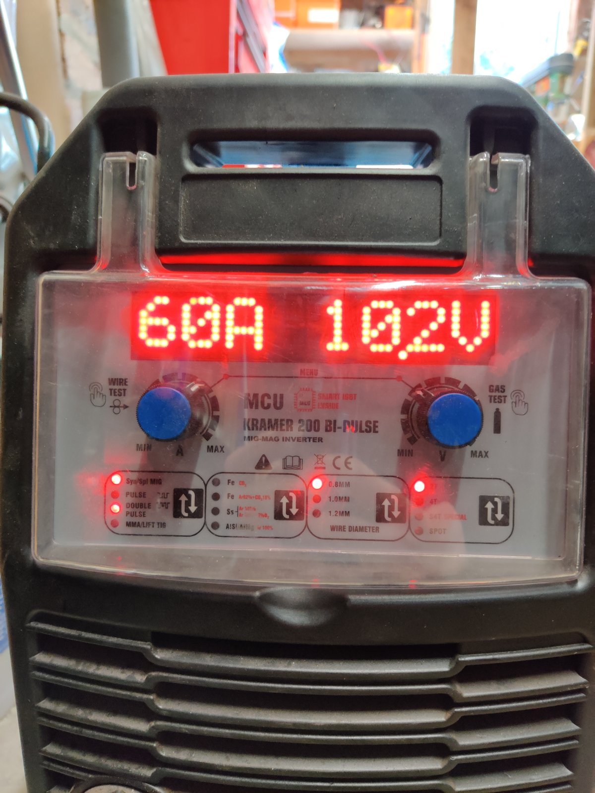

In my limited experience (& learned lots from the Sages on here & the tutorials) you need a welder that can weld nicely at 30A or ideally even less.
For size, weight, portability etc it sounds like a small inverter mig is for you.
Which one and how good - depends on budget I suspect.
I know @doubleboost has reviewed kit and is one of many who might advise on the actual welder.
